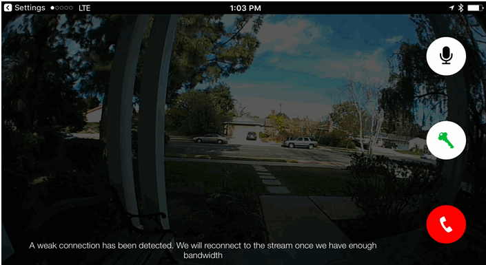

My Skybell HD had been working perfectly. However, now I’m constantly getting the error (screenshot attached) that I have a weak connection and that the stream will reconnect once there is enough bandwidth.
Has anyone else experienced this?

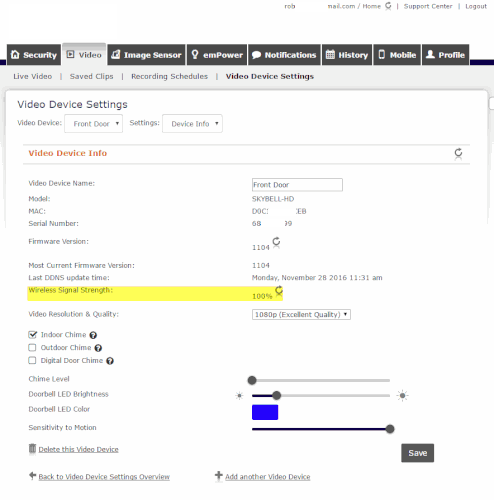

My Alarm.com show the following stats (notice strong connection to wifi) wifi is at 100%.

Signal strength is not the only indicator of connection. The Skybell HD needs a relatively high signal to noise ratio, effectively a very high quality signal is needed, and wifi network strength is not a quality indicator. In order to determine the signal to noise ratio and quality, you’ll need to consult your provider. They will have back-end diagnostics through Alarm.com.
An option is to dial down the resolution and test. Less data from the lower resolutions should see fewer instances of this error.
