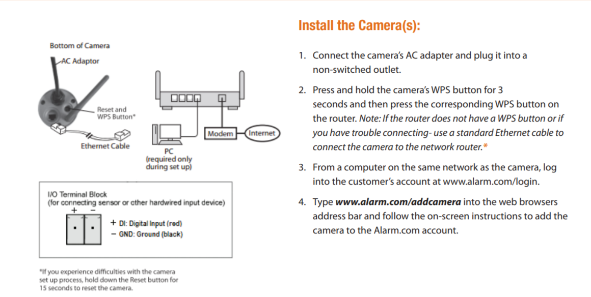

For the 720W you can either use a patch cable to your router, or you can use the WPS button on the 720W to connect it to your network. It would probably be easiest to use the WPS button. See the attached instructions from ADC.
Once connected to your LAN, ADC can discover the cameras on your network and you can go through the setup process for them on the video page in Alarm.com. Alarm.com walks through step by step.
Following the instructions, I accessed the WPS button (I assume that was it, was on back of camera covered by a cover that I screwed off) and held it down for 3 seconds. It went from red to blinking green. I went inside to my router and hit the WPS button there, however, the light on the camera never stopped blinking. Therefore, nothing showed as a camera I could add on the alarm.com set up. Does the fact that I have a security password on my home router prevent anything?

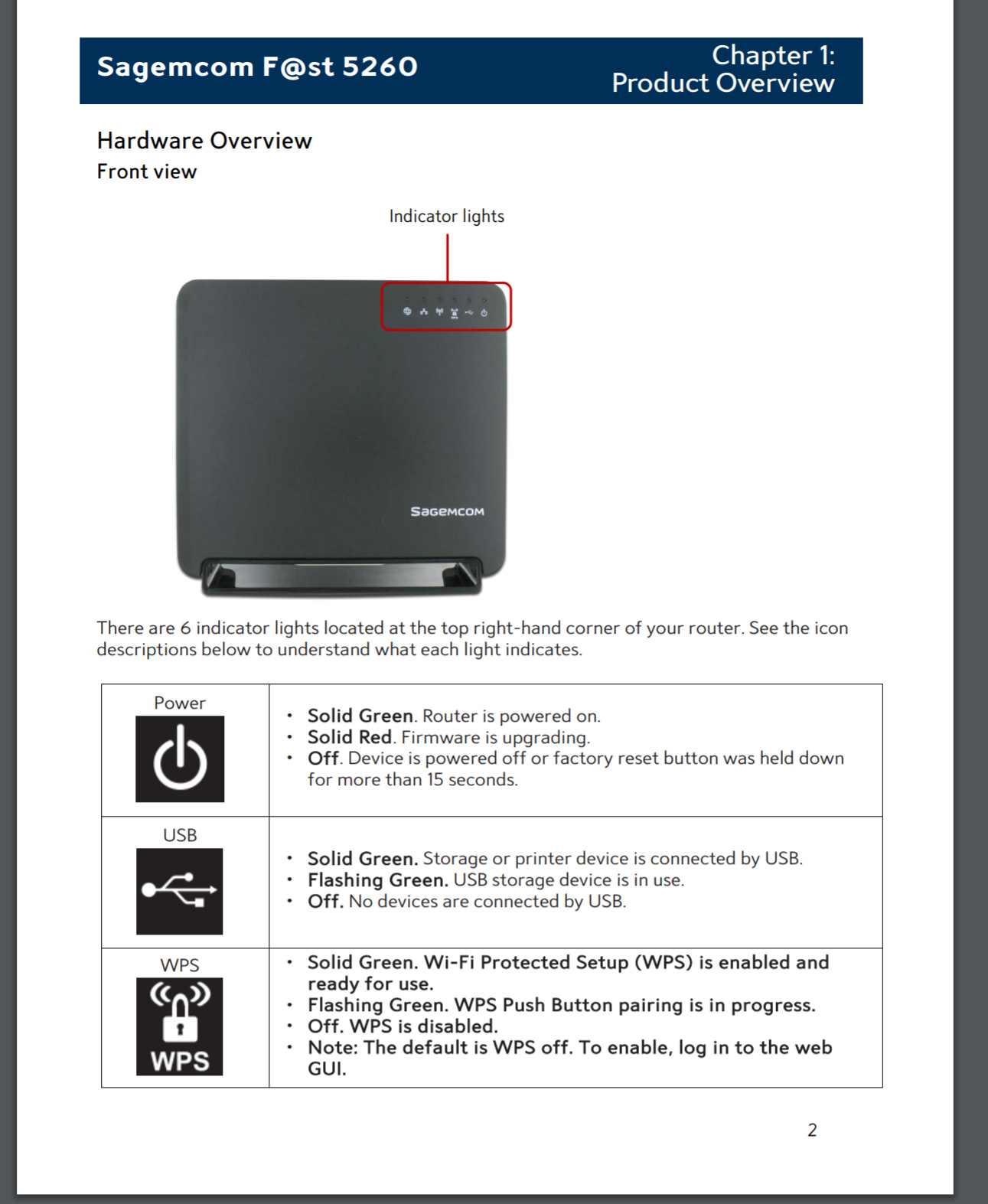

It is a Sagemcom Router that Spectrum provided to me. Should I be hitting the WPS button the router first, then the camera? I had been hitting the camera button first then the WPS
sagemcom router model 5260 to be exact.

Per the support page I would press and hold the router button first. Then within 2 minutes press and hold the camera’s WPS button for 3 seconds. Any luck?
Also, according to the manual regarding that router model WPS, WPS is actually disabled by default. Double check the router WPS LED indicator based on the attached page from the manual.
This worked! Thanks!
