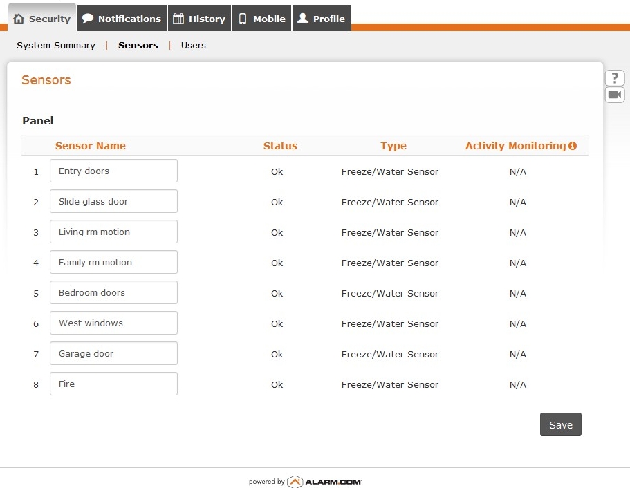

My Alarm.com sensors are all showing as Freeze/Water Sensors. They are not, but I cannot change their settings. The panel is an NX8V2 and the sensors are the usual entry/exit, interior follower, fire, instant entry, etc.
Do you have any idea why the sensors are showing as Freeze/Water or how I can correct them?

The system (panel) itself has been working, without issue, for many years. It is only the monitoring that is new. Alarm.com is able to read the Sensor Name, and other data, but not the sensor type. See image.
I checked the zone type programming (location 25) and all 8 zones have a valid entry. They are type: 3 (ENTRY/EXIT DELAY 1), 13 (INSTANT ENTRY GUARD), 5 (INTERIOR FOLLOWER WITH AUTO BYPASS ENABLED), 25 (CHIME ONLY) and 8 (FIRE). None of them are freeze or water sensors.

One extremely important detail is what the dealer site reports as the zone type number for each of the sensors. You cannot view this on the user site. This is a big question: whether there is a discrepancy between the dealer and user website, and whether there is a discrepancy between the numbers reported and the type name displayed, as in does the actual fire zone show Zone Type (8), but still say Freeze/Water, etc? You would need to have your provider confirm this.
It might be a good idea to try making a change to one of the sensors in location 25. Change an entry exit sensor to a perimeter or perimeter to entry exit temporarily. Does this change reflect any change in Alarm.com after the sensor is activated and a cell test is run?

Short answer: ADC derives the Sensor Type from the Zone Alarm Event Code in locations 110, 112, 114… Changing the Zone Type in location 25 does not have any effect.
