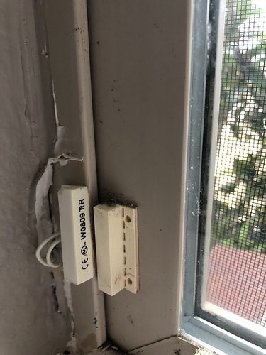

I attached a picture of the sensors. I don’t know the make or model.

Ahh that makes sense! The sensor in the image is not a wireless sensor but a wired one. The sensor has likely been converted into wireless with a takeover module. Wired sensors would have been previously utilized by an older panel, the board for which is likely in a metal can located in the basement or attic.
If using the 2GIG GC2 panel, this would probably be the 2GIG TAKE-345 Super Switch.
This Super Switch would be connected to the old wired sensors, then it would convert the signal into wireless. If you are utilizing this device, you should see it somewhere around the metal can. Can you confirm?
If the sensors are already learned in, you should see a few sensors with a TX-ID in sequential order all on loop 1 (the loop that sensors being utilized by the TAKE would use) the TXID would be something like XXXXXX1, XXXXXX2, XXXXXX3, etc.
