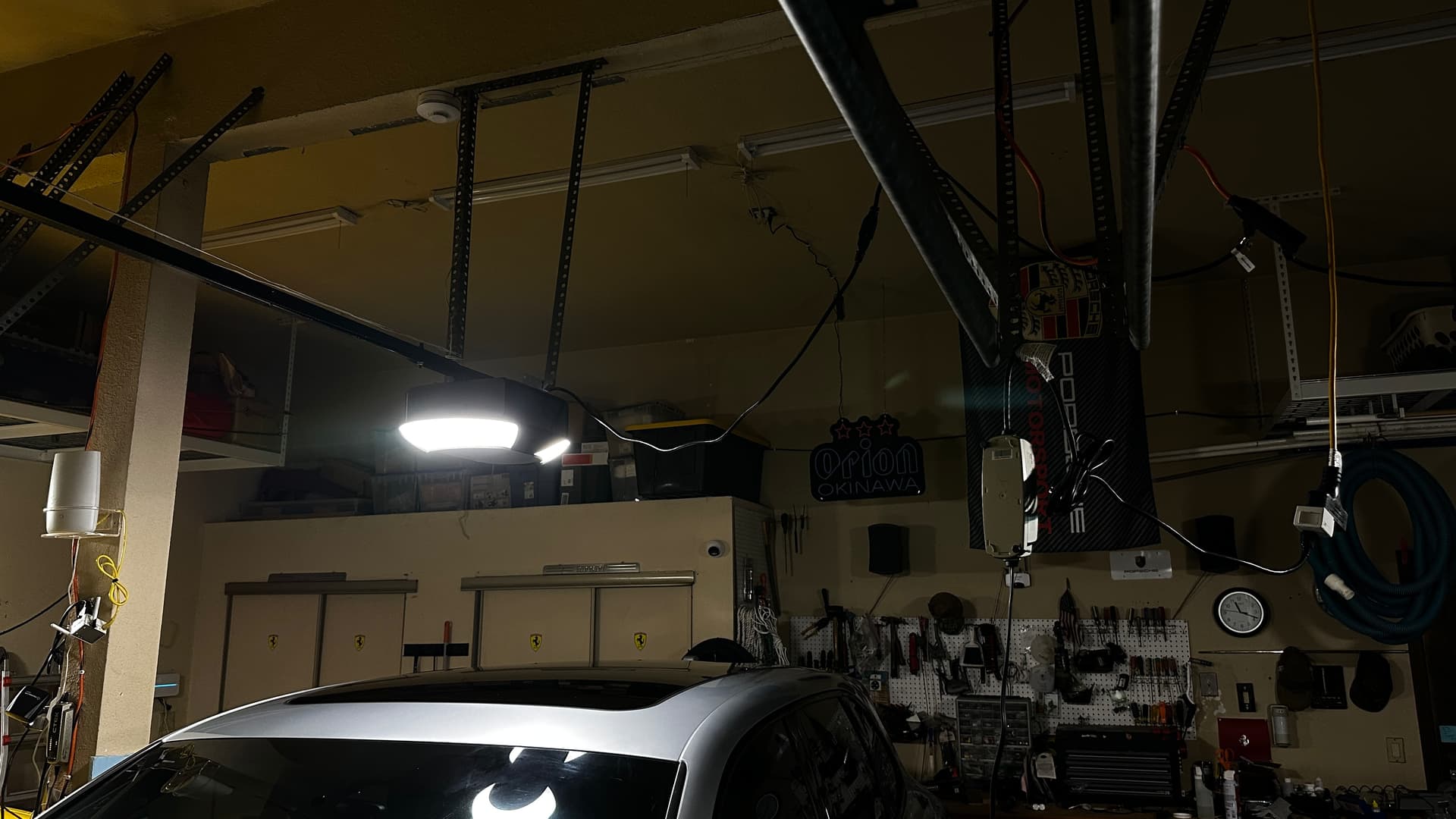

Where is that device in relation to the others? So that we can best assist, can you provide a photo of the device with MyQ serial number ending D811?
Serial ends in 0051
Here is a picture. Notice how close the router is to it on the top left of the photo on the pole
I have lots of devices like dash cams sprinkler systems. Pool equipment connected to that satellite working fine
The next step I would perform is to have us delete the overhead door for you and then you default the overhead door and learn it back into the system. It could be something with the overhead that could most likely be fixed with the factory default.
