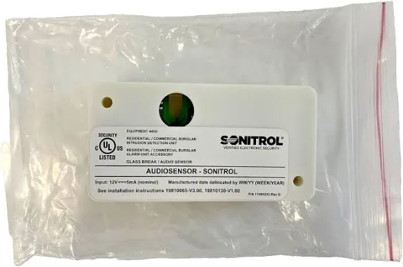

Hi Vidail , good morning here’s a photo of the back of sensor
I tried finding the manual online but wasn’t able to find it. Based of what I read in their website, it looks like it has a microphone so operators can hear into the location and see if there is a break in happening. The IQ Pro would not be compatible with that. Based off the picture, it looks like it is 12VDC which can be powered from the panel. It would mostly depend on if the device has normally open/normally closed outputs for when the glassbreak is triggered.
Ok , I’ll see what I can find about normally open or closed
