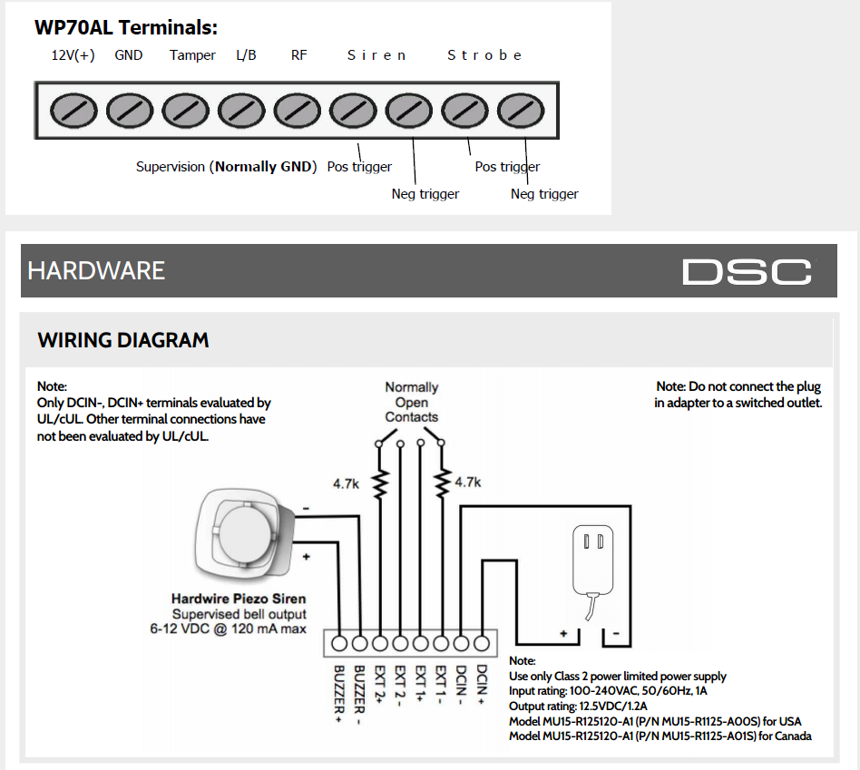

Does anyone know the correct wiring for the Secor Wireless Siren WP70A and a DSC Touch / Qolsys IQ Panel as per the attached diagram
The Qolsys panel only has a buzzer output for external sirens. If compatible, you would wire Buzzer positive to trigger positive, buzzer negative to trigger negative.
thanks for getting back to me Warren, you are correct, the qolsys panel only has a buzzer output. I’m connecting the buzzer output to a WP70A wireless transceiver which then sends the siren alert to a wireless siren.
