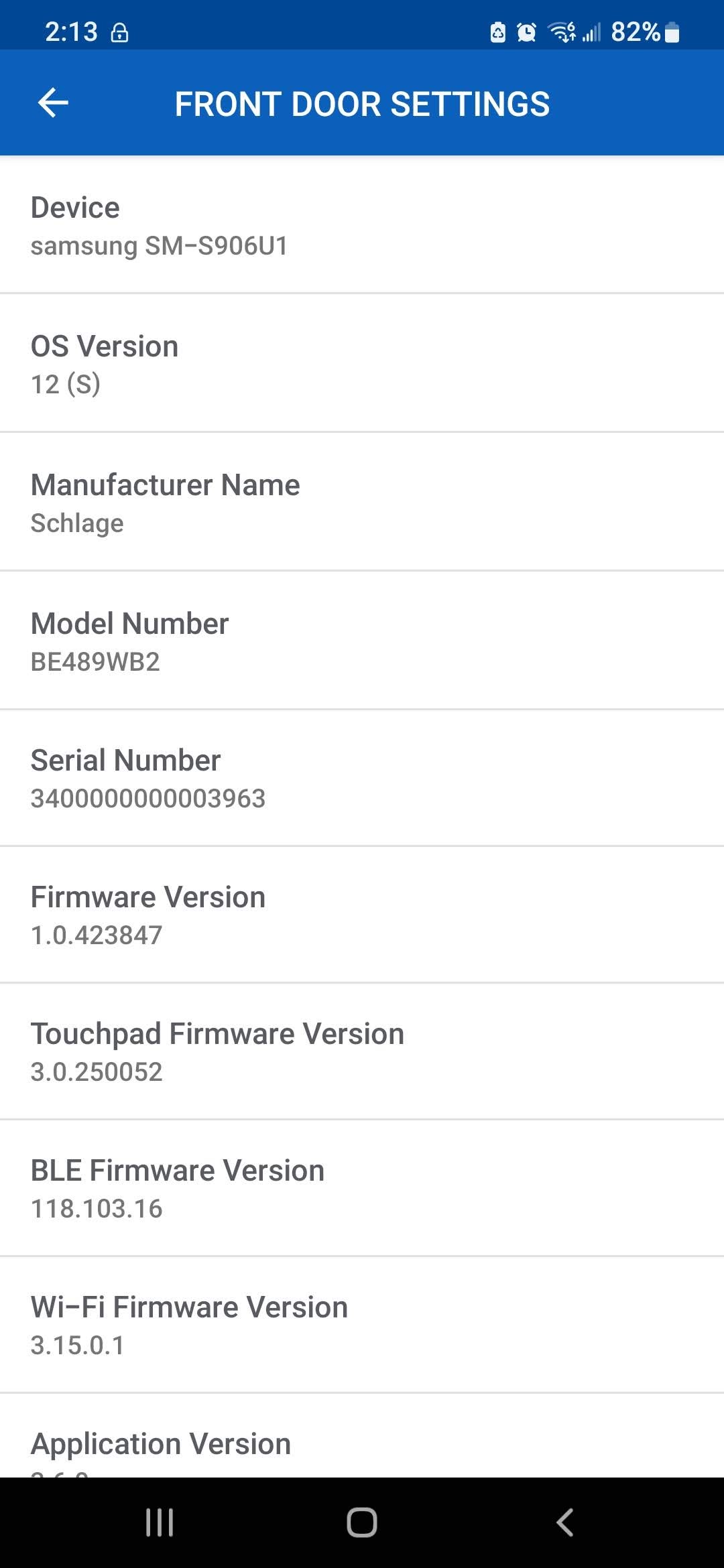

Yes, I am able to lock and unlock the door from within the Schlage Home app and within the Ring app. Attached are photos of the box showing the model number and a screenshot from the schlage home app showing the lock information.

Interesting and frustrating, alright I’m not seeing anything myself in the version info you provided that leaps out, but let me run all those in your screenshot by Alarm.com and see if there are any known issues and what they recommend.
