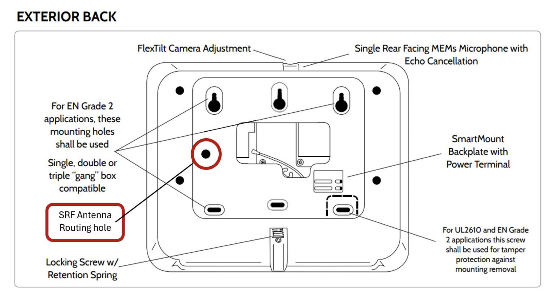

This how to will explain how to route your antenna when mounting you panel to avoid any low signal issues with your sensors.
Wall mounting:
  1. Install the keypad at its permanent location.
  1. There is a hole on the right side of the base that gives the best exit route for the antenna. Create a 3/16 hole or another size similar through the plate and the wall to get access to the inside of the wall.
[/grid]
  1. Once you have the hole done, install the keypad and inserting the antenna through the hole created.
Desk Mount
  1. Feed the legacy SRF antenna through the hole in the desk stand behind the locking screw. Separate the antenna and DC power wire as much as possible. Ensure the antenna is unobstructed and away from the DC power wire.
