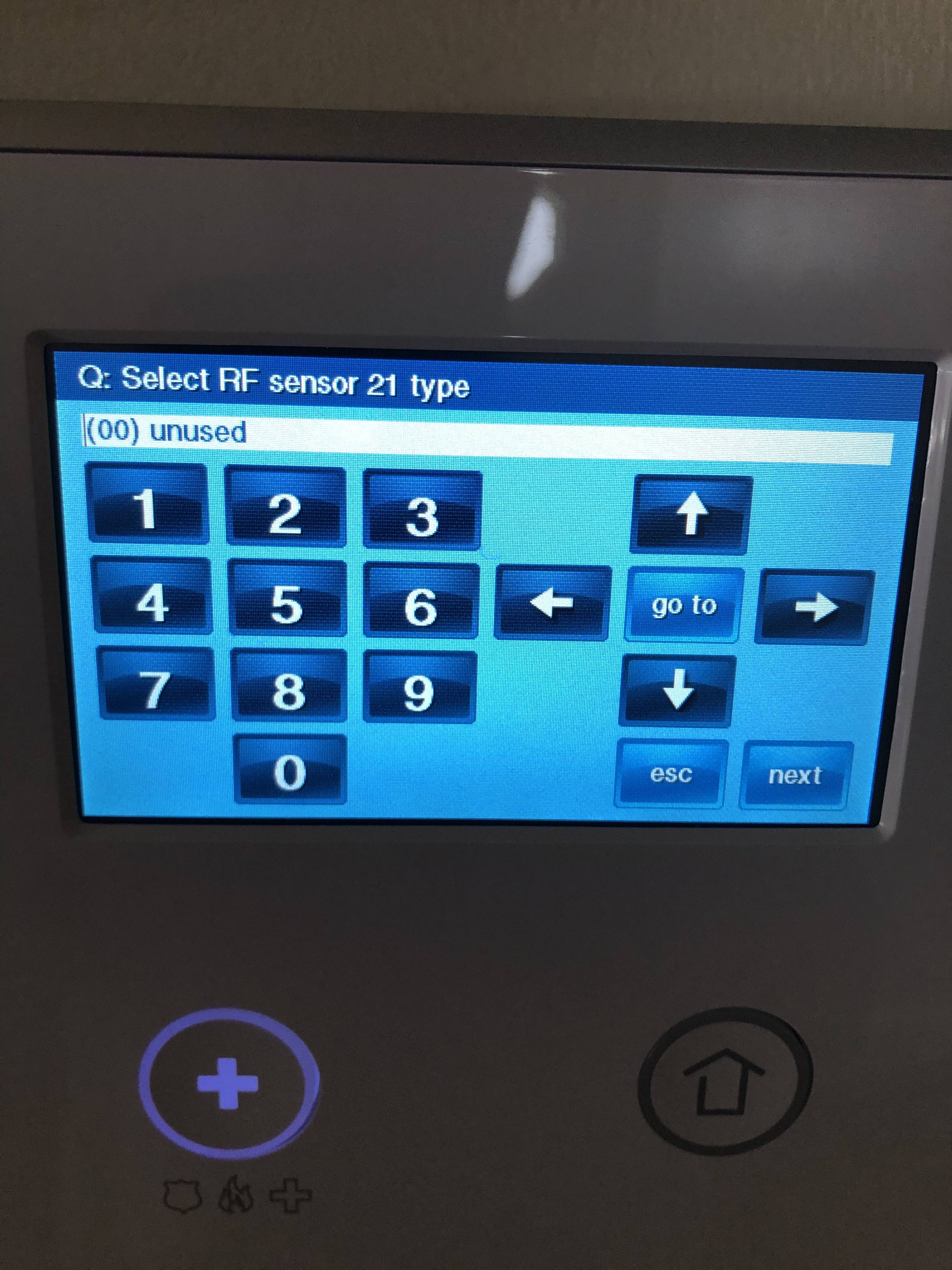

You could temporarily mark that sensor zone as unused in programming so that the panel is not listening for smoke detector signals from it. It looks like that is Zone 21.
Enter System Configuration and scroll to zone 21. Scroll down to change the RF Sensor Type to Unused.
Hey Jason,
Can you check I did it correctly. I marked it as disabled. Before I take it out of test mode.
Thanks.
Hmm, I am still seeing the Downstairs Smoke detector listed in your equipment as a fire zone.
Would you mind posting a photo of the sensor programming for that zone where you set it to unused?
Yes, that would be the setting to change. Zone 21 is no longer reporting as enabled in ADC.
You may want to do that for zones 22 and 23 as well (the High Heat and Freeze detector zones for the Downstairs Smoke) if you are going to replace that device. However those weren’t the zones causing the alarm issue, it was just the smoke detector portion.
