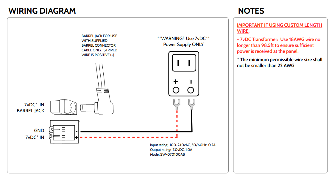

Typically you would just extend the length by splicing on some additional cable onto the barrel wire (if short run needed) or replacing it entirely and using the input terminals on the back plate rather than the barrel.
See the guidelines from the instruction manual below.
Cable is available from local hardware stores in custom length. How long of a cable run are you going to need?
