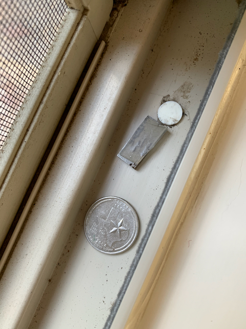

Can you post a photo of the magnet and sensor? (just want to see the diameter) Can you describe how far off the centers of the two are?
Thanks. Photo below. The magnet thickness is about the same as the quarter.
Since the magnets are only held on by some adhesive, I can reseat/reorient them. However, I’ve tried that with the one in the photo, but it hasn’t helped.
Aha, that may actually be a magnet issue. Those strip adhesive magnets are generally weaker and have a different magnetic field than the type of sensor magnet that typically comes with those sensors. The magnet is typically also recessed into the window.

Is there no recessed magnet in the window at all?

Nope, no recessed magnet. All of the windows follow the same set up.
