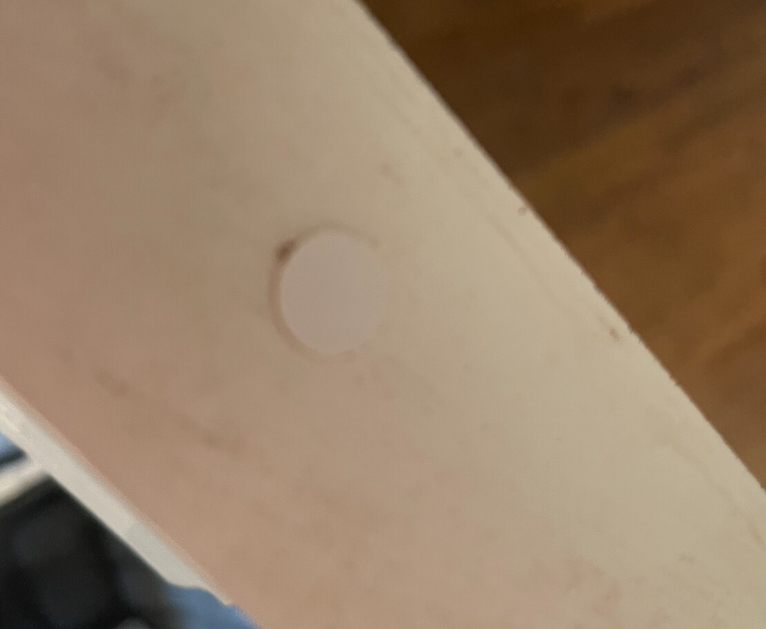

I’m getting low battery notifications on all of our doors sensors. We have recessed sensors installed, I am not sure how to remove them from the door to replace the battery since there is no slot for a tool or coin to remove them.

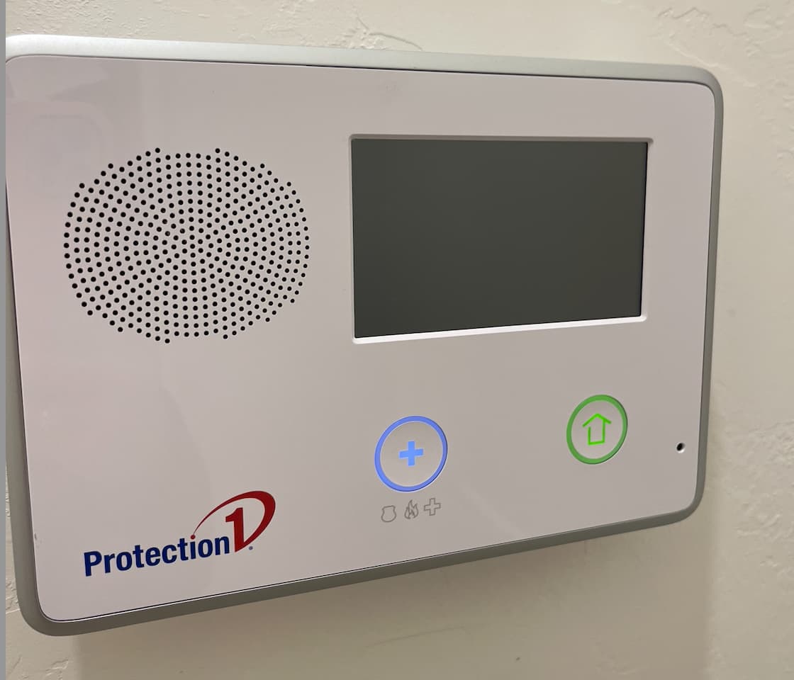

I’ve attached a picture of our panel, as well as of our door sensors. Could someone please let me know how to remove them and replace the batteries? Thank you so much.
Those look smaller than a 2GIG wireless recessed sensor. They look like they are probably wired recessed sensors.
Looking at your account it looks like your first 8 zones are all reporting low battery.
This means those are likely all wired sensors connected to a 2GIG TAKE-345, the wired to wireless takeover module. The low battery is the large 12VDC backup battery used for the Takeover module, it is not a battery internal to the sensors.

Actually, I think it’s the panel on our 2GIG TAKE-345 that is low. What little green battery pack do I need to order to replace it? Thank you!
The low battery currently showing on your account is for the 2GIG GC2 Panel. A backup battery pack is found below.
