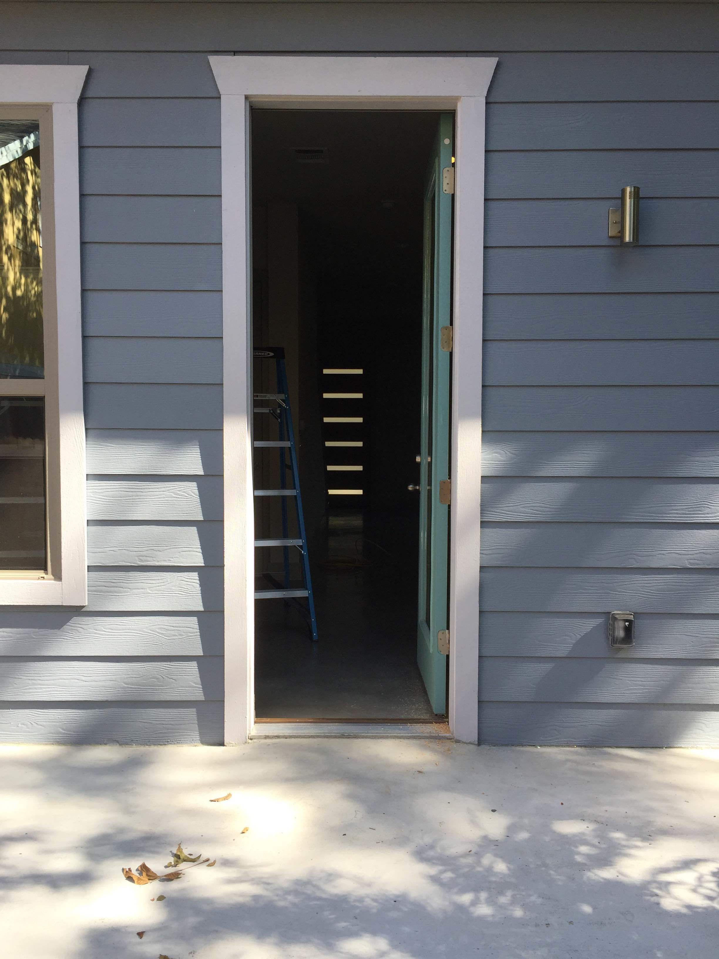

I am installing my system. The sensor for this patio door works great in terms of communicating with the system. However, the door needs to be open a ton before the sensor reads the magnet as being far enough - see attached. How do I “weaken” the magnet strength?

Check the instructions for the DW20. Unfortunately you do not want to install it on the hinge side of the door like you would a plunger type sensor. The DW20 should be installed handle-side.
Yeh - I see that now! Please see my second post on this thread.
