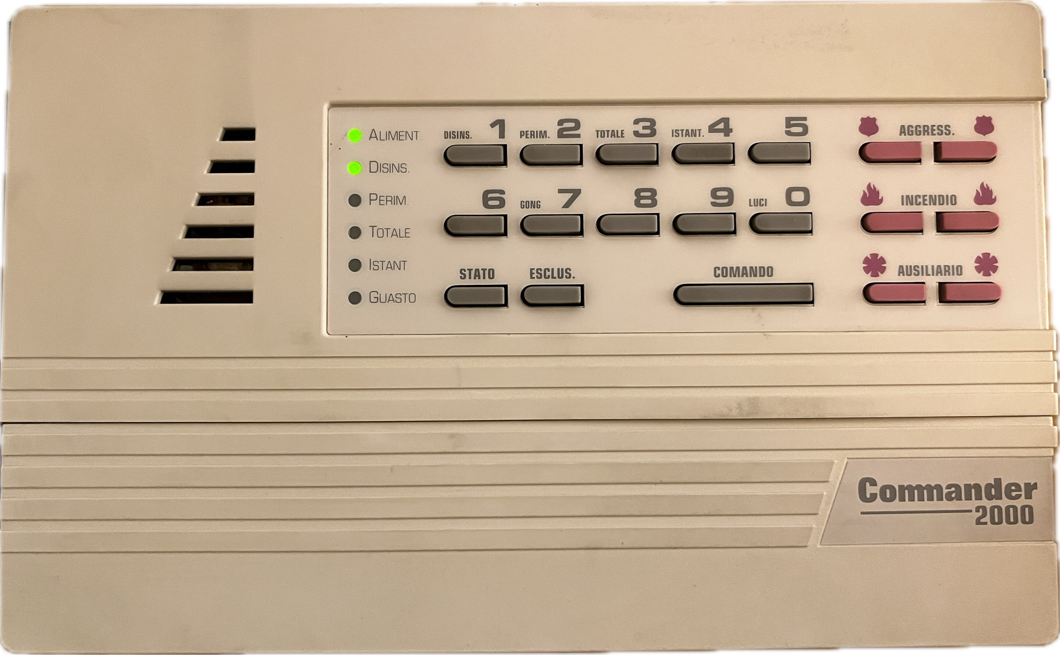

Just curious I don’t think I have ever seen a iti commander 2000 can u post a pic of the keypad if not that’s ok

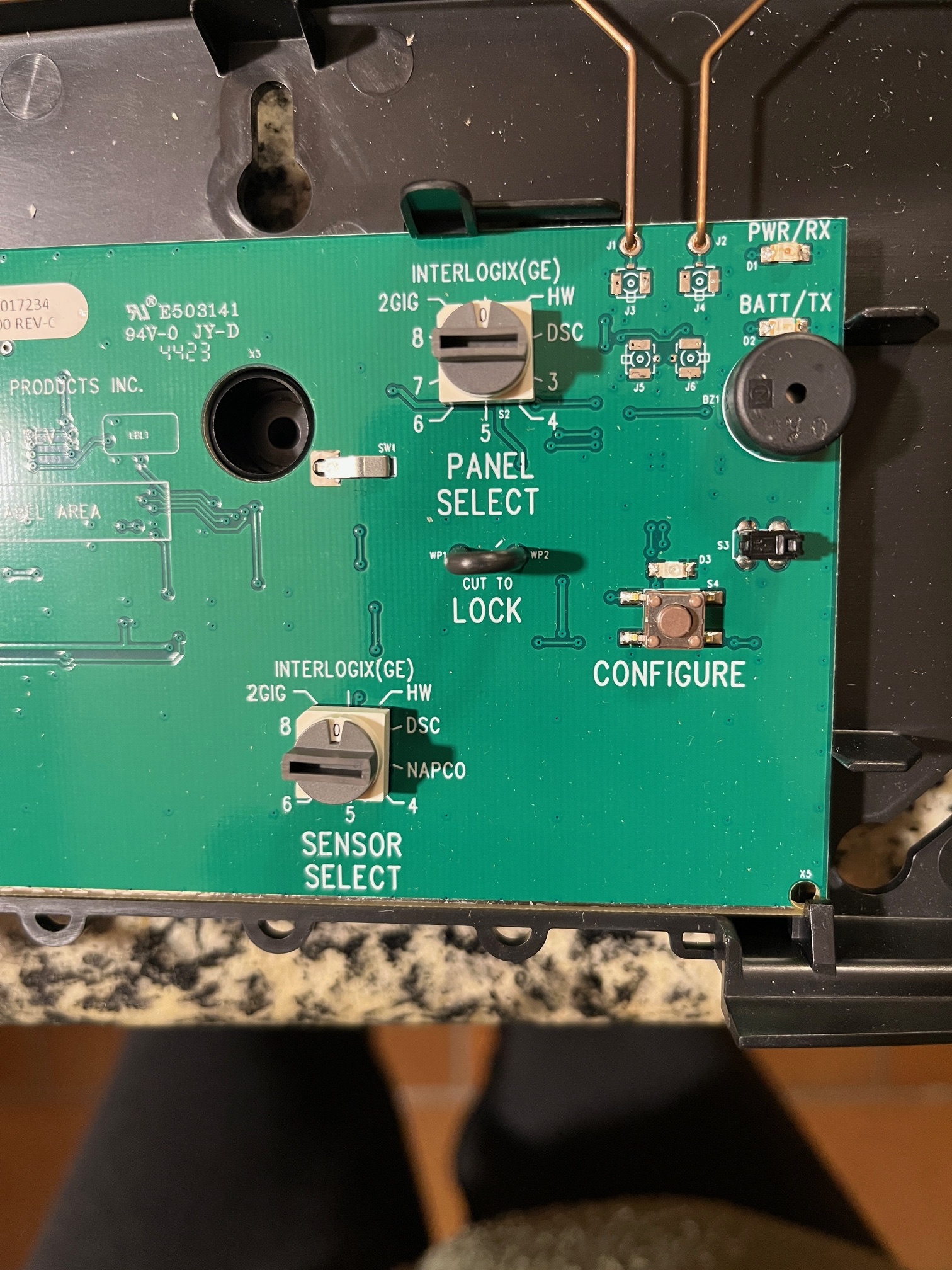

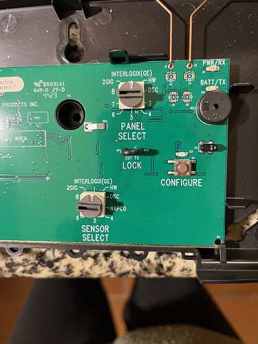

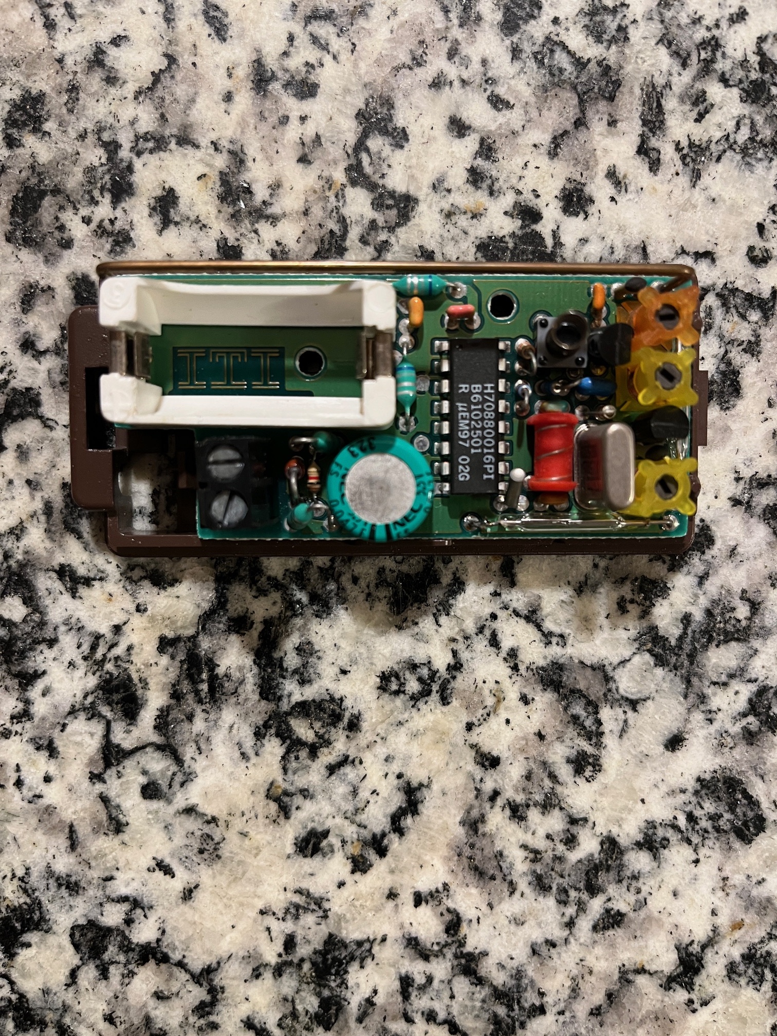

Can you send a picture of the configuration on the RE524X and one of the sensor?
About the translator, not much to configure (same brand, selectors on 0-0).
