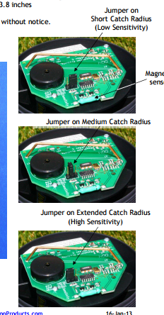

The RE104 registers large objects disturbing a magnetic field. There is also a sensitivity adjustment using the jumper on the board. See the attached image.
Have you tried setting it for high sensitivity?
