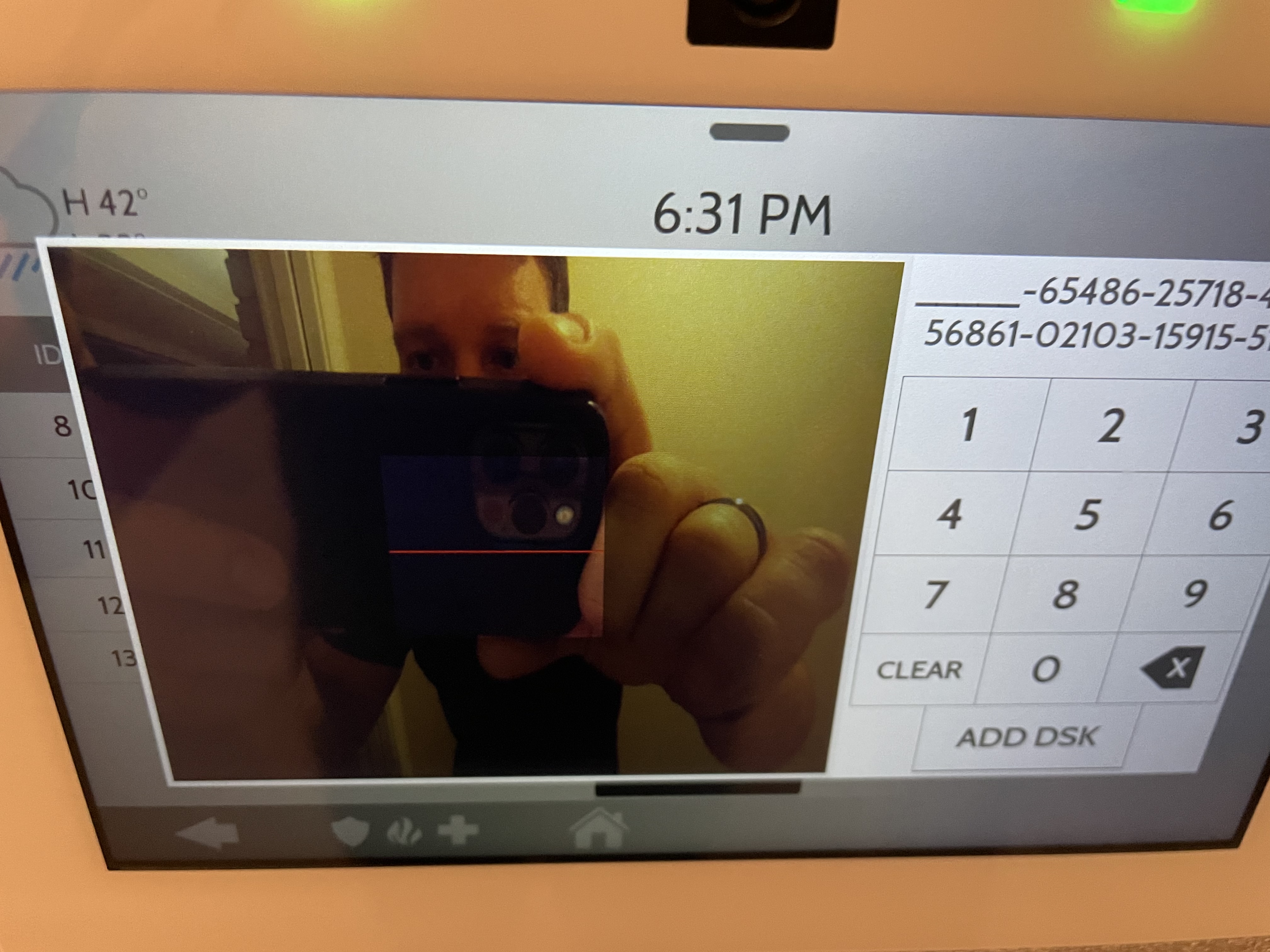

Secondly, the three zwave devices I mentioned are still not showing up to n the app. I think I might have an idea what part of the issue might be. All 3 of the zwave devices are switches. When I added them to the panel I was prompted to enter part of the serial number of the device or scan a QR code (see pic below). The packaging of these devices hit the landfill years ago. I proceeded by making up a random number. The panel didn’t seem to mind and the devices worked fine from the panel.
I’m assuming I need to unscrew the switches and find the serial numbers on the switches? Could that be a reason I’m still not seeing the devices on the adc app?
The panel is requesting the first 5 digits of the security key. The DSK is required for S2 security devices. Filling in random numbers will not work. They will not report properly.
You’ll need the DSK from those devices. It may be printed on the device itself.
Alternatively, when first adding the device, does the panel prompt you to use S2 or S0 security? If so, try just selecting S0.
After retrying the zwave switches a couple times everything is working properly. I didn’t change anything that I know of just reinstalled a few times until it stopped prompting me for the serial numbers upon pairing.

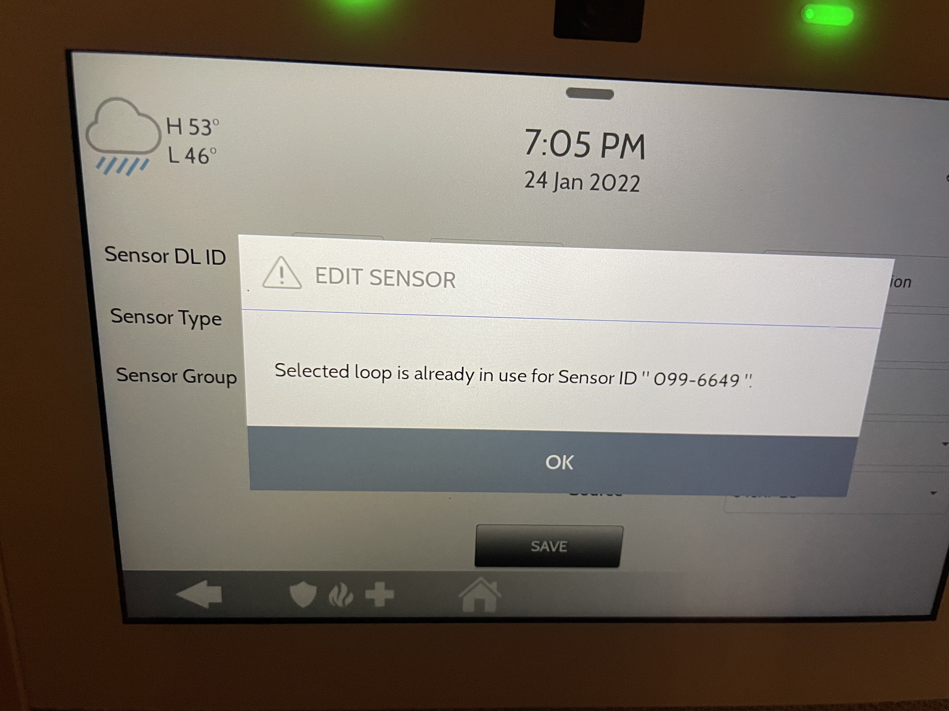

However, the garage side door still does not work correctly. When I try to switch it to loop 2 is says that it’s always on that loop. I can switch it to loop 1 and 3 but it won’t go on loop 2.
Ah, that means you already have that sensor’s TXID programmed as a different zone on the panel using that loop.
In this case, looking at your sensors, you have 099-6649 TXID as the “Back Door” as well. double check your programming for those zones and make sure the TXID for your sensors is correct.
