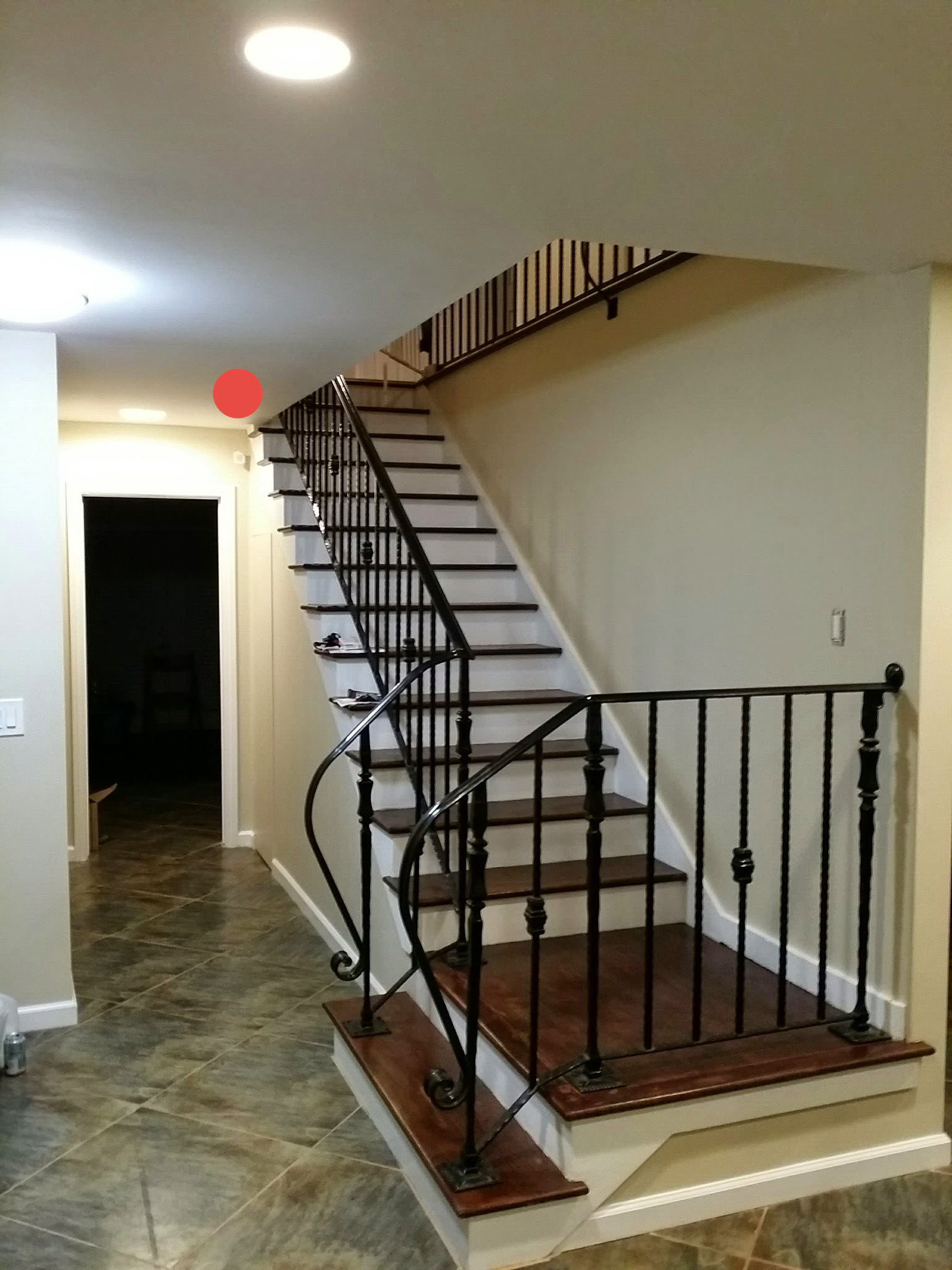

Thanks for the photos - that helps. So I know I will be placing a smoke at the top and bottom of the stairs - I have attached 2 pics - first one is where I think I should place the downstairs smoke and the second is the upstairs hallway near the kids room. There is an AC return, so not exactly sure where I should place the CO detector. I will be putting a smoke in each of the 5 bedrooms, but have to figure out the best place so that they are far enough from both the ceiling fan and the air conditioning register.
Other end of the hallway (picture 3) I will place a smoke (red dot) and CO (green dot).
Lastly is the family room, just off the kitchen. Is a couple feet from that beam on the family room side a good placement for a smoke and CO? To the left of the camera is the entrance from the garage.
