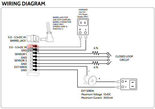

Hey Guys since i just ordered the 345 iq panel will this siren work on it without anything else https://www.amazon.com/gp/product/B002PN8YT4/ref=ppx_yo_dt_b_asin_title_o00_s00?ie=UTF8&psc=1 here is the specs
New Patented Piezo Dynamic Technology, 15 watt Dual Tone Siren, 100 MA (+/- 10%), 110 db (+/- 3db), 6-12 volt DC operation, High impact ABS housing, Weather resistant, suitable for indoor/outdoor use, New low-profile design 4 1/4" x 1 1/4" (106mm x 30mm), Light weight 3 oz (84 gms), Attractive Display Box this is what siren is current installed on my panel as we speak
A wired piezo won’t work without a separate power supply. The panel does not provide power across the siren terminals, they are just a relay.
However, that wired siren would be fine at 100ma to power via a 12 VDC power supply and switch on/off via the IQ Panel 2 relay.
