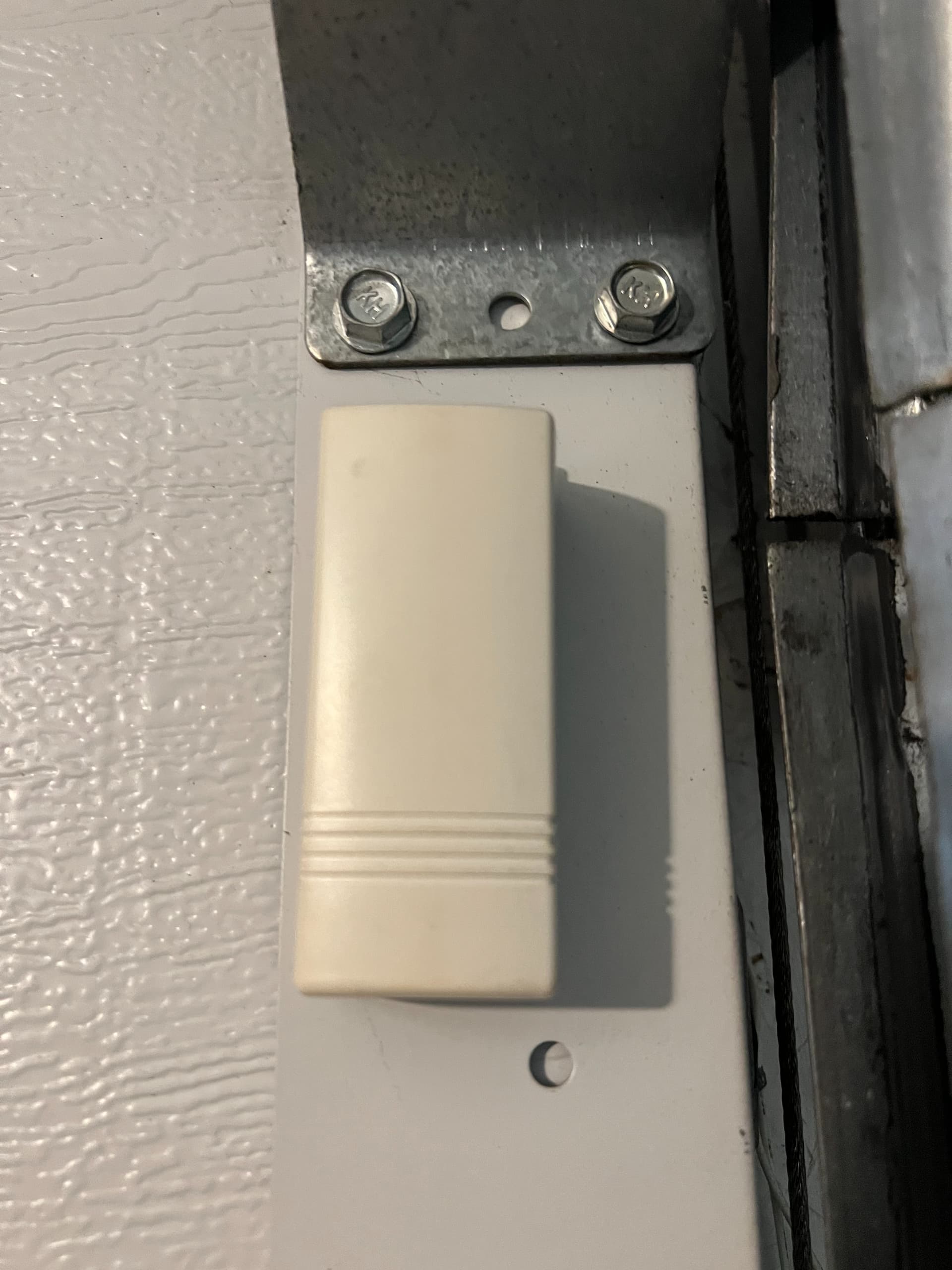

Would you mind posting a photo of the device where it is installed and the programming page on the Qolsys panel?

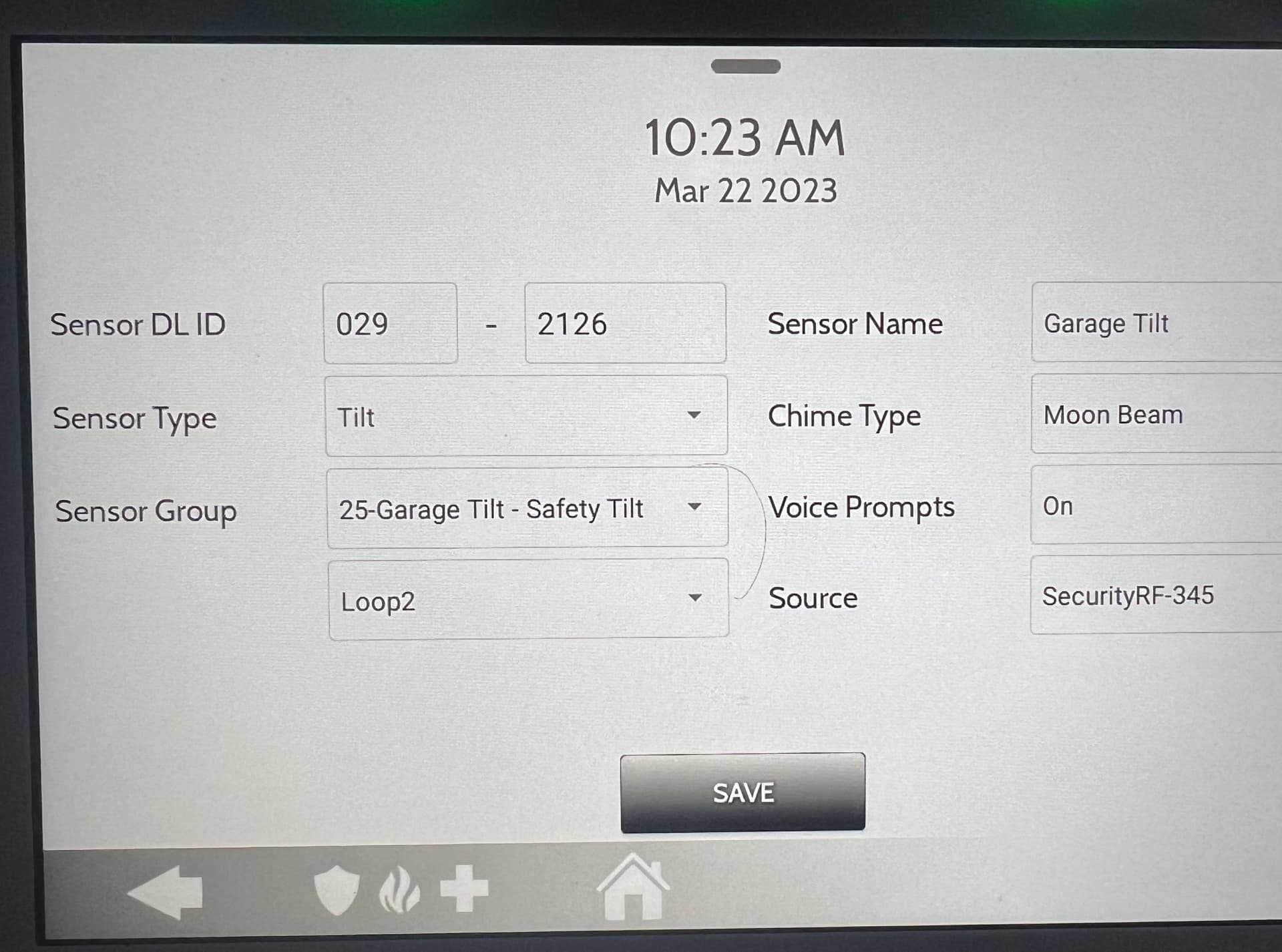

It’s the 2gig tilt sensor that is still programmed on my 2gig. Here are the config settings on the Qolsys.
Can you confirm the model number of the tilt sensor? If this is the 2GIG-Tilt1-345 it needs to be Loop 1.
If it is an old resolution products model or other model I’m not aware of the loop number may depend on orientation.
I did try Loop 1 and that doesn’t seem to make a difference.
Alright that is a resolution products tilt, it should be loop 2 in that orientation.

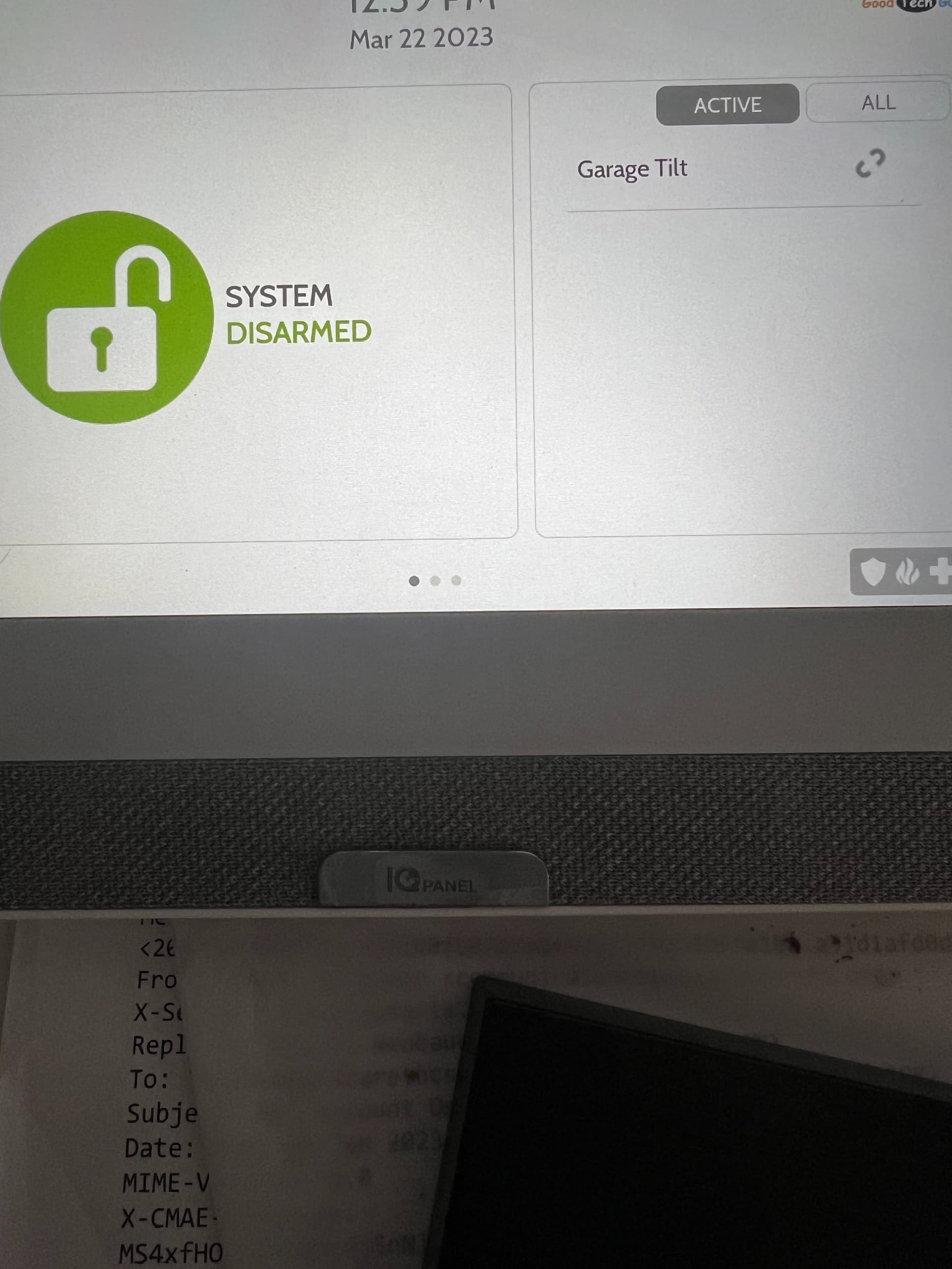

Can you provide a photo of the status on the panel with the door physically closed where it shows active?
If you toggle the status, open and close the door a couple times, does the status always show the opposite?
Instead of selecting Tilt as the sensor type, if you select door/window and sensor group 25, does the same problem occur?
I did try toggling it a couple of times and I also tried changing it to door/window. Same issue.
And to confirm, does the status always immediately show the opposite of what the physical state of the door is?
yes

Well, I decided to try Loop3 and then rebooted the panel and that didn’t help either. I then changed it back to Loop2 and now it seems to be behaving correctly but time will tell. Not sure how/why it corrected itself. I am pretty sure I rebooted it earlier when I was trying to resolve this. Maybe the change to Loop3 and then back to Loop2 caused it to start behaving.
