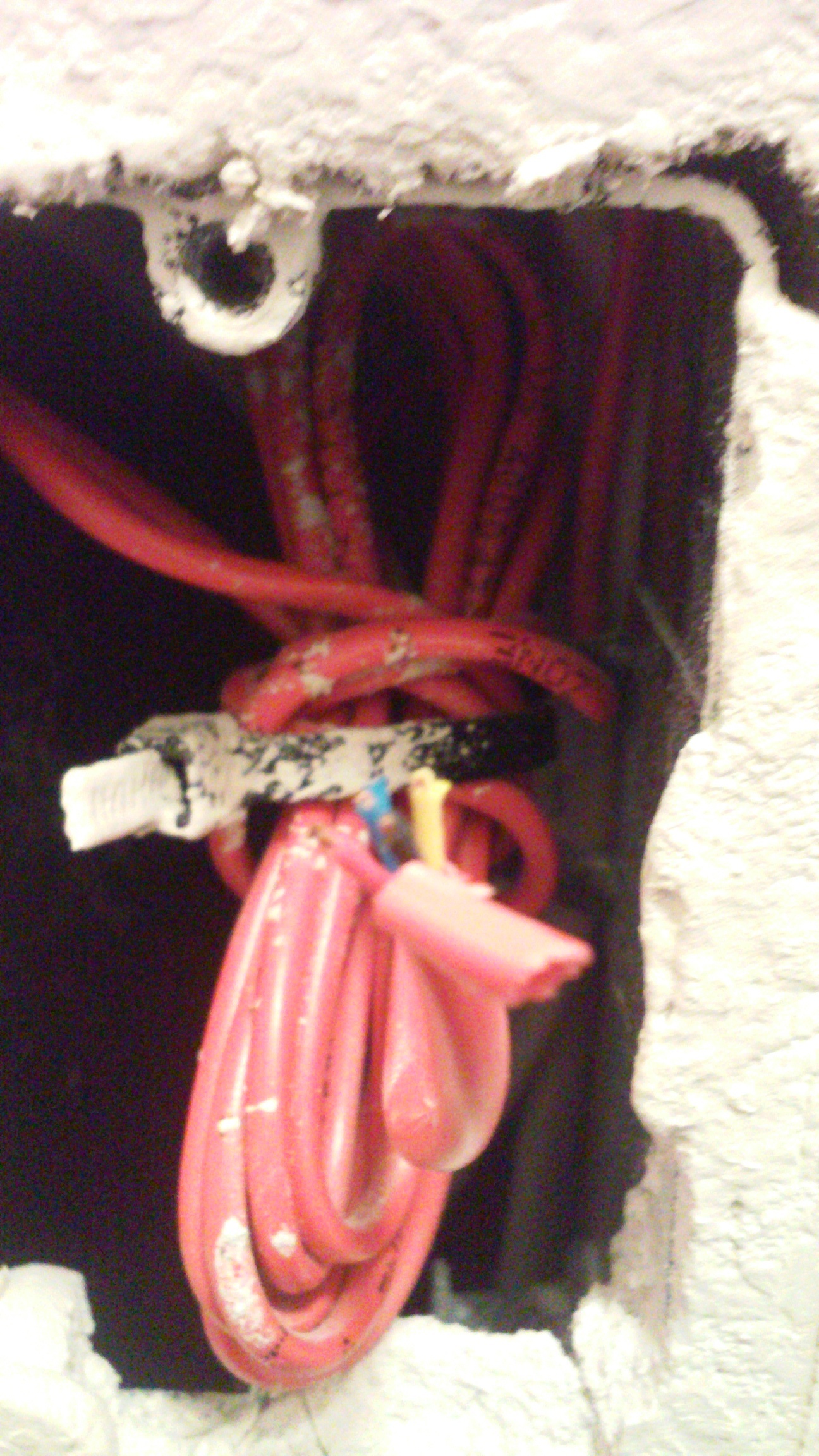

I don’t have any power outlets where I’d like to install it, but the house was pre-wired for a security system. Can I use the red cable in the wall next to the door? I believe I have traced it to the bedroom and into the attic where there is an outlet right next to it.
If so, the existing attached power cable to the Qolsys has a black and white wire, but the red cable in the wall has red, black, blue, and yellow inside. Do I use red (+) and black (-) and disregard the others?

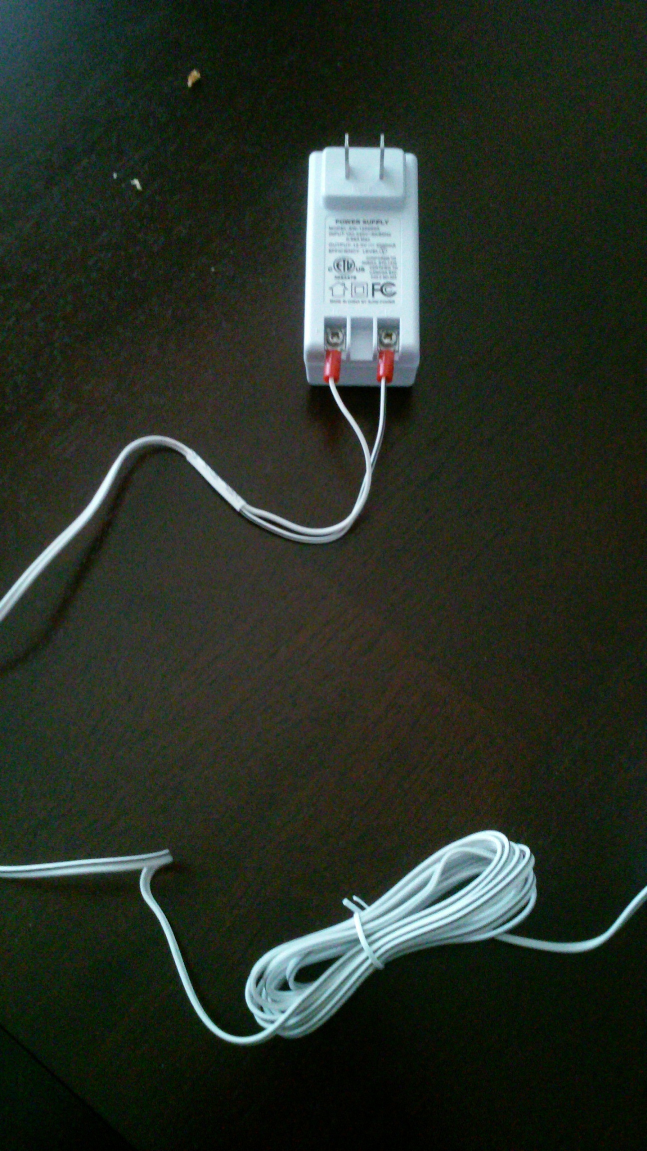

The transformer that comes with the Qolsys Panel provides the appropriate amount of power you want to use. The wire that comes attached to the Qolsys Panel that was shipped to you is mainly for testing purposes and convenience.
If you have existing wire already in the wall you could use that provided its not compromised. Make sure that you have tested or traced to determine that the two ends of this red cable are part of the same cable, not two.
The colors don’t matter as much as matching them to the corresponding + and - on the transformer and the panel. If the cable run is 20 feet or more you may want to double up on the conductors.
What gauge is the cable? If it is 22 gauge cable you will most assuredly want to use two conductors for positive and two for negative. Match the colors at the terminals of the panel and transformer positive to positive and negative to negative.
It is definitely longer then 20 feet since it starts downstairs and goes to the far end of the attic. I will combine two wires on each and ensure they are the same on both ends and let you know how it goes.
