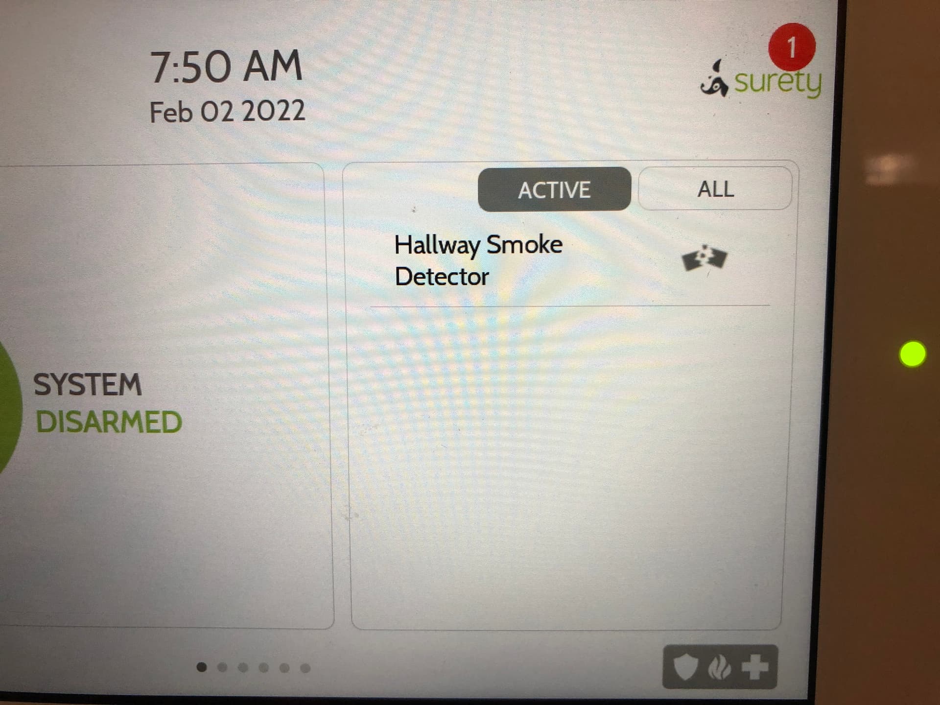

I am having the same issue with a Qolsys smoke that will constantly tampers. I have removed the batteries waited over a minute before putting them back and verified the sensor is correctly in its base. Any idea what else maybe the issue?

This was purchased new from Surety. It seemed to work properly, except for the tamper, when installed. The green led blinks periodically. I have removed the batteries waited a minute and put them back. I am unable to clear the tamper.
If you test the detector by holding the test button down until it signals the panel, does the tamper go away once the panel receives that signal? (make sure to place your monitoring account on test mode in the system manager if you have professional monitoring)
If you take the sensor down and bring it closer to the panel, then manually press down the tamper switch, does it update on the panel?
I put the system into test from the system manager. Strangely when I press the test button the smoke detector starts beeping but the alarm panel does not see it. It does not show in the Activity section on Alarm.com either. Although Alarm.com does show the tamper.
When I press what I believe is the tamper switch the panel does not clear the tamper on the panel Active pane.

Does the Sensor ID in programming match what is printed on the smoke? Based on programming, it should be 28812E

I finally located the sensor ID on the smoke detector. It was in small print instead of on a sticker and is 2ACC22. I do not know what device is sensor ID 28812E.
I deleted 28812E from the device list, rebooted the panel, removed the batteries from the smoke for 15 minutes and then added it back at the panel. When I added the smoke back at the panel two sensor ID’s popup when I went to add the device. 2ACC22 and 28812E. I added both. 28812E reported a tamper and 2ACC22 was normal. Both of the sensor ID’s came up as smoke detectors although I only have one smoke and one carbon monoxide detector currently. The CO detector is sensor ID A77EA1 which matches the sticker on the device. I then deleted 28812E again. I then put the panel into test mode, pushed the test button on the smoke detector the smoke and the panel both went into alarm and alarm.com reported the alarm. I am not aware of any missing sensors on the panel. How do I determine what sensor ID 28812E is.
