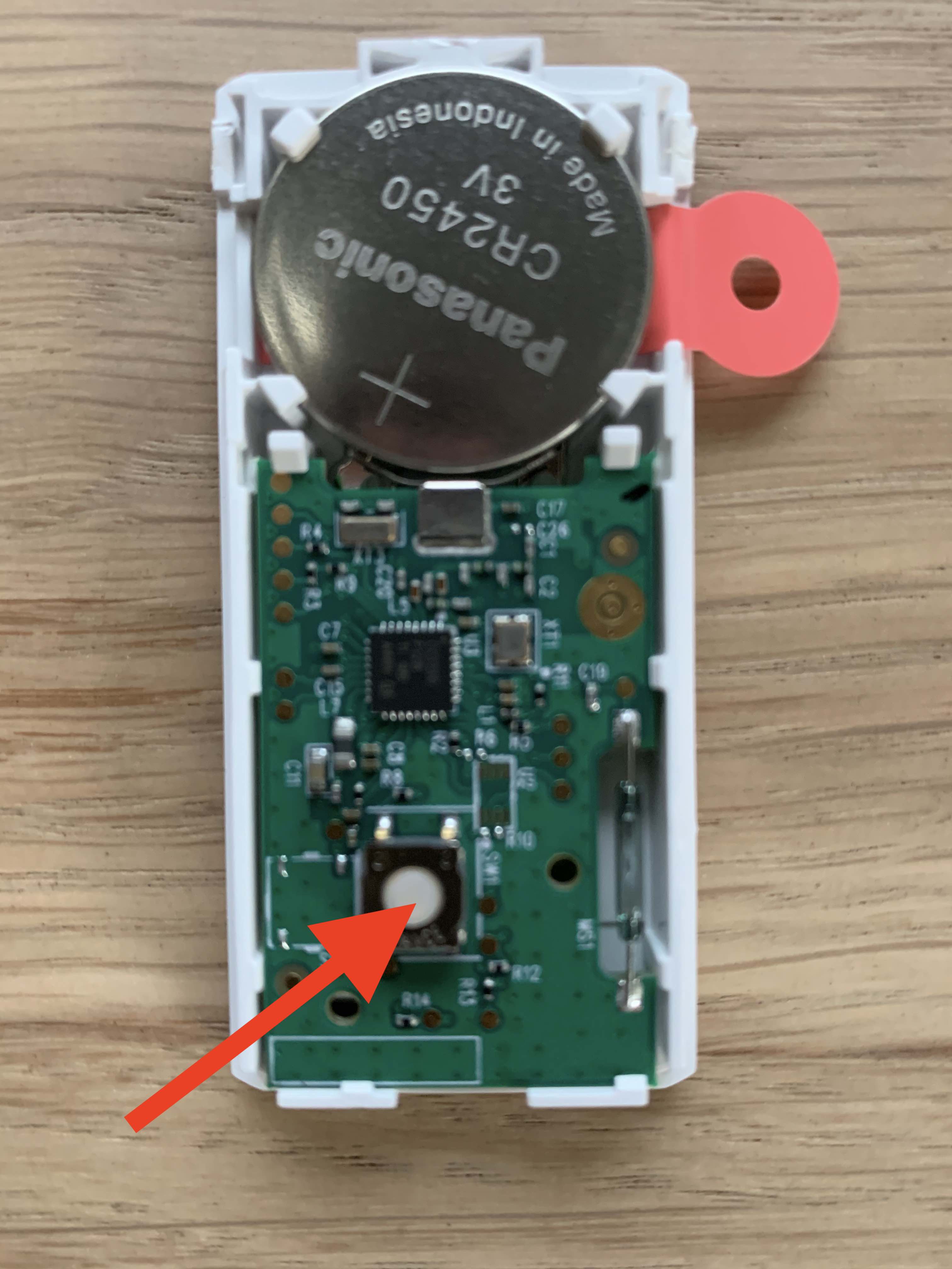

That’s actually the button you want to push. I added one earlier today by pushing the button for 3 seconds until the yellow (or green?) LED flashed while the panel was in automatic learn mode.
I attached an image to confirm.
Thank you Nicolas. I appreciate the photo. It confirms I was doing everything right. However, I have just discovered something important. Tyler G, I have determined that my Qolsys IQ panel is an IQ Panel 2. Could you confirm for me that to use the G power sensors I have to have an IQ Panel 2+. That would make a lot of sense. The panel was installed two years ago at just about the time the IQ Panel 2+ came out but I had no idea the “+” is so significant. (They should have called it a 3). I’m guessing I need to upgrade to a 2+ as I can find nothing that says Qolsys ever released a daughter board to upgrade the 2.
