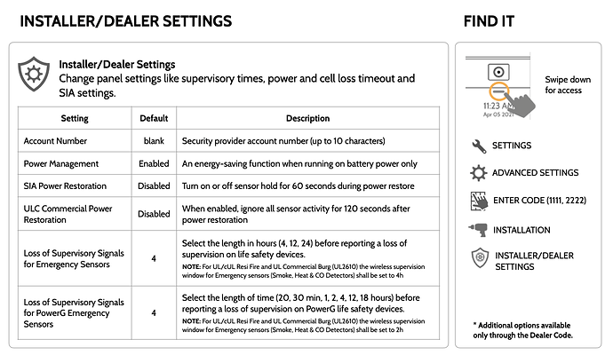

Thanks for the tips. One more question when those units are out of power and run on battery do the disable wifi and Bluetooth immediately? This is something that i noticed when i unplug the power supply. Both of those radios go red in status screen.
That’s configurable. If you disable Power Management the they’ll stay on when the power goes out but the battery will run out faster.
