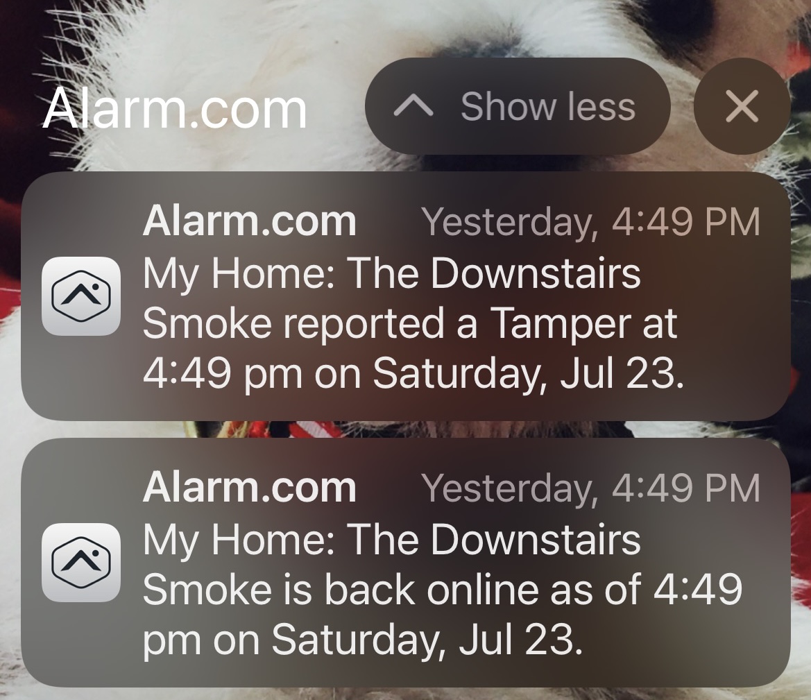

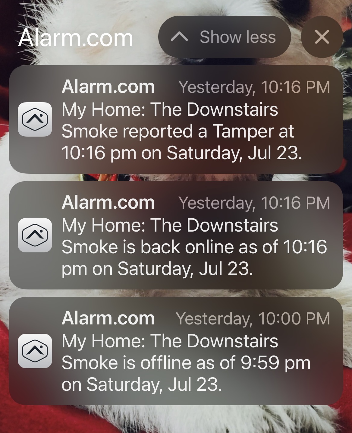

I have a Qolsys 4 system with an IQ remote. All of a sudden I get these brief tamper alerts on the Interlogix - SLX-AD-T3 FireFighter - Wireless Fire Alarm Monitoring Relay. It is brief but annoying because the IQ remote panel is dark at night but lights up when tamper occurs.
