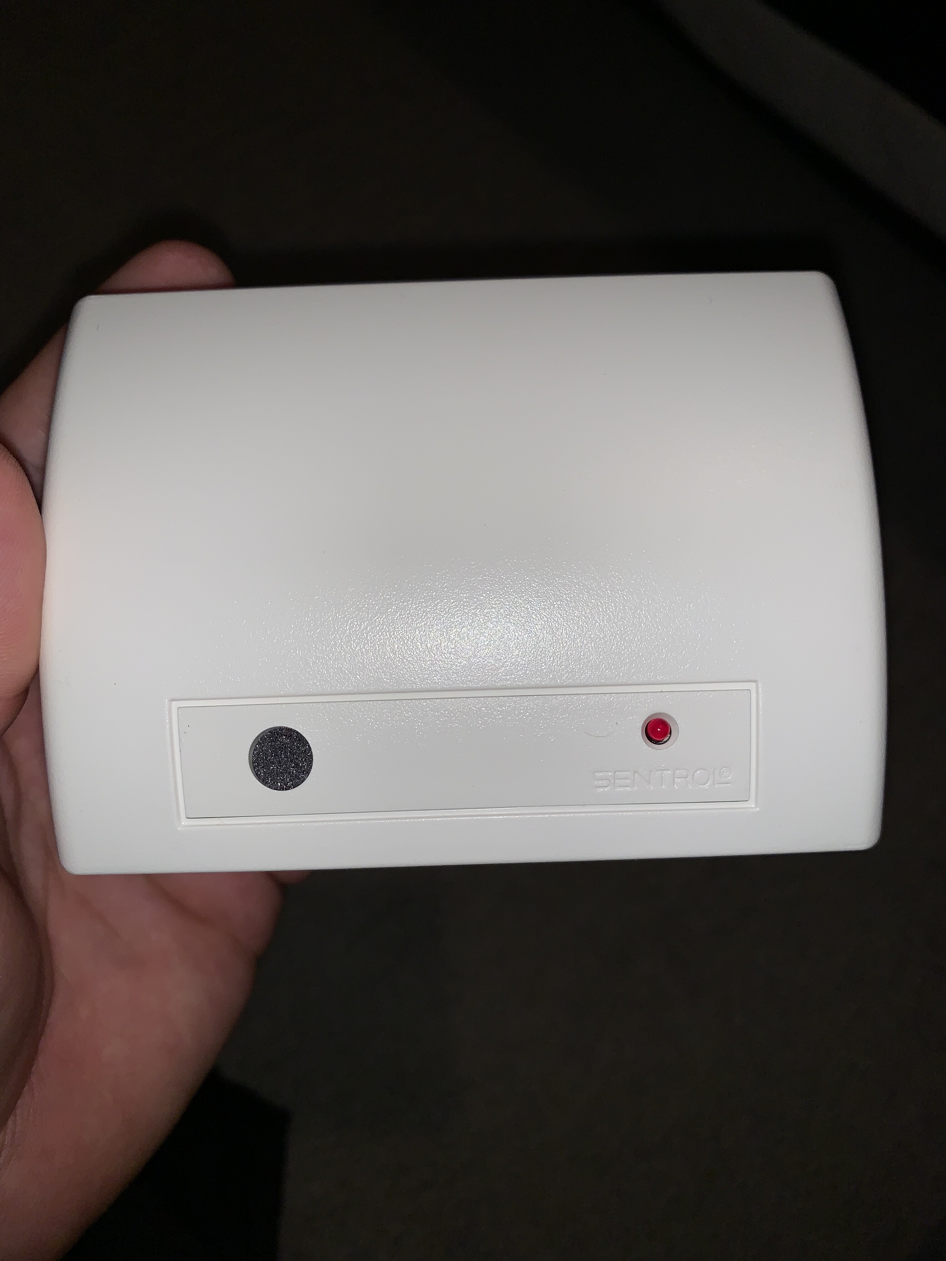

1… can I use some of my Frontpoint sensors with Qoslys iq 4? Door window sensors, motion detector, glass break sensors. I have quite a few unopened.

If you send the model numbers of each device we can confirm, usually these are on the back of the sensor.
They have used compatible sensors in the past, but it would be good to verify. I do believe they began using some Alula/Resolution Products 319.5 sensors. The Sentrol/Resolution Products glass breaks are identical I believe, but I’d like to verify that with a model or photo.
The IQ Motion is a 319.5 Mhz senssor made by Qolsys. It would be compatible.
Yes all them sensors will work how many cos and smokes do u have there is a certain date that u have to replace the smokes and co detectors reason I’m asking if u don’t have many at all of either id recommend going ahead replacing co and smoke or replace in the near future but rest of the sensors will work completely fine
Looks like you’ve got it sorted, and I would just echo that Life safety devices may be at or nearing end of life. Other than that you should be good to reuse those 319 sensors
