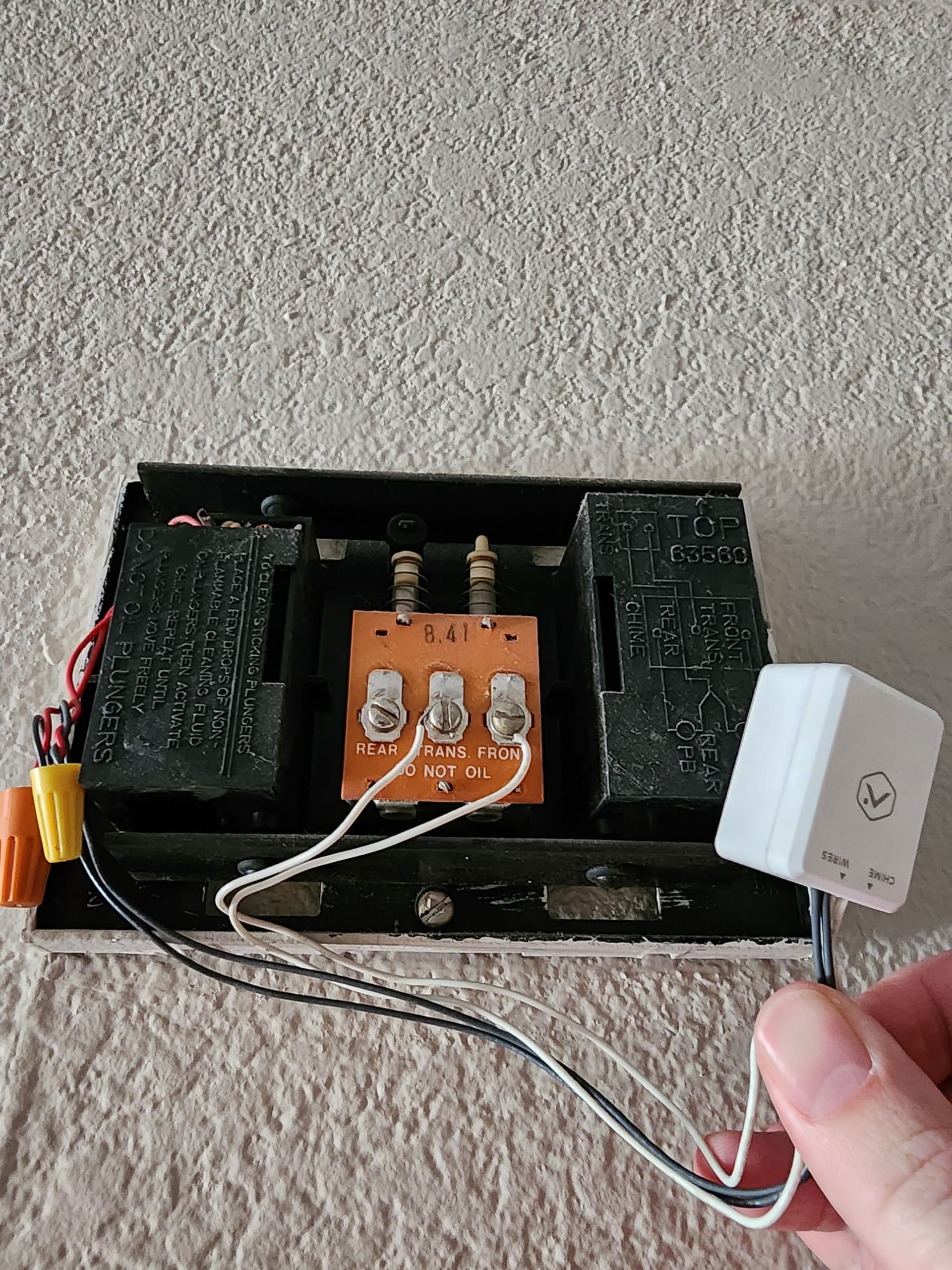

What are the specs of the doorbell transformer? Can you post a photo of the power module installed?
I have the power module installed. I took a picture of it so you can let me know if it looks good. Im not sure what a tranformer is or where that would be. I know where the breakers are.

Here is an idea what it will look like.

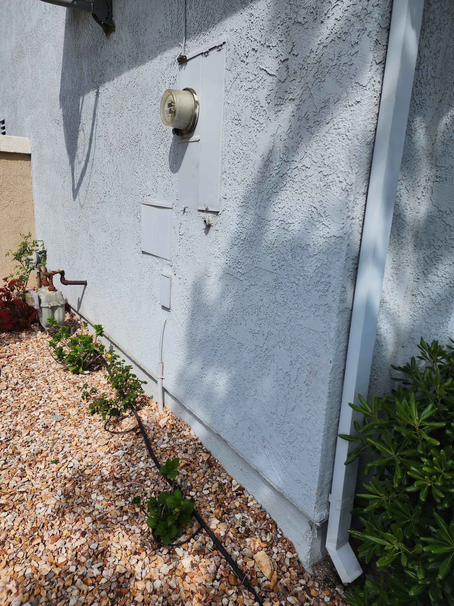

Unfortunately nothing like that near the panel. There are other small boxes for tv and telephone.
The doorbell transformer is not usually going to be outside.
Do you have a utility room? Are the main electrical panel circuit breakers located under one of those panels outside?
