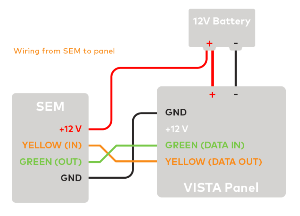

Are you using the provided power wire for the Sem-300 to get power from the battery instead of the panel?
Config of panel
SAVS20P5
Z3488 R
I wired power to panel not battery. Should I change it to battery for the power cycle?
Config is SAVS20P5
Z348 R
Yes please. It should look like this.
Updated power to battery.

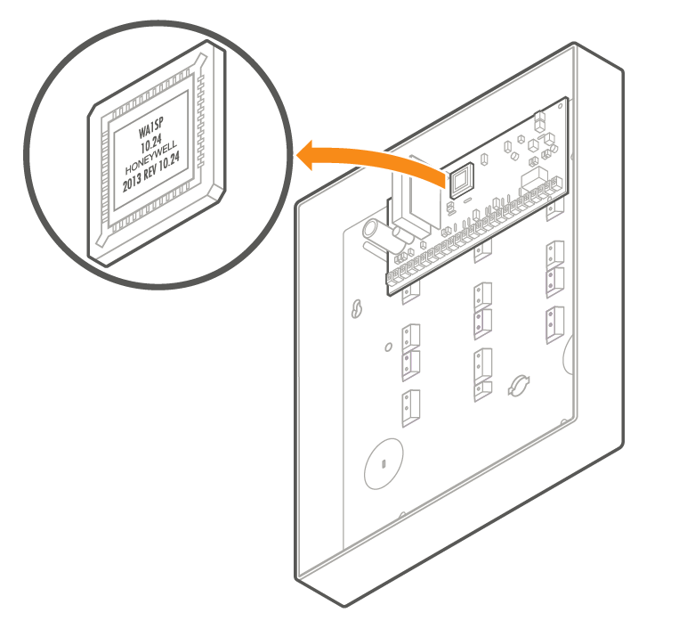

Is there a sticker that looks something like this? With a revision number and year?
WA20P-10.26
RESIDEO2024
REV 10.26.
Above is the sticker.
2024 and 10.26 is definitely not to old. :grin:
