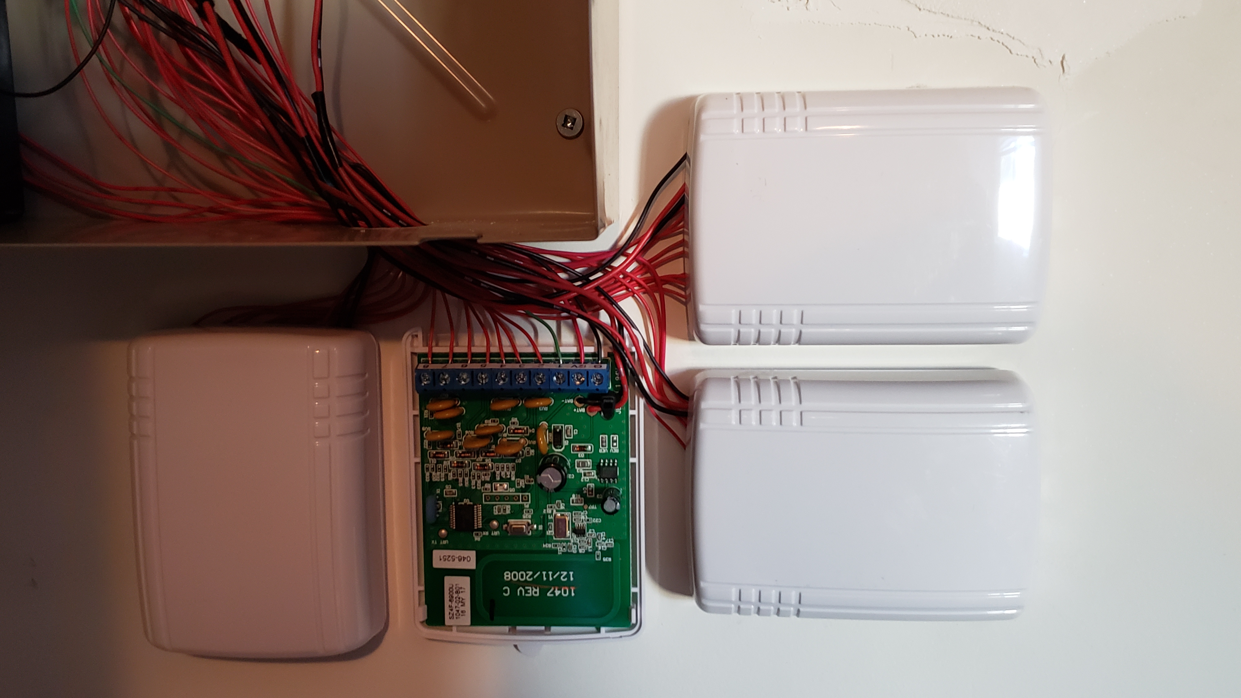

I have a factory/dealer (unbranded) gc3 panel. 4 smart switches for wired sensors.
its all good to go, I will buy a new Cell module, but I have a question about Smartthings integration.

A question about legacy wired sensors and 2gig smart switches. So I can place the order.
Will using the 2gig takeover smart switches and my current setup work with seruety? I belive all I will need is the gc3 4g cell sled. But I may ne missing something.
The cart looks fine. I’m curious, do you know for sure that you will need a new cell sled? If the one you have is a 4G Alarm.com module then you should be able to reuse it with our service. If it’s 3G then you will need a new one.
Yes, you can use the 2GIG takeover switches and your current sensor setup will work fine with our service. Nice wiring, by the way.

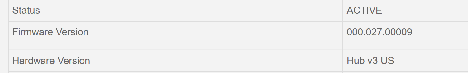

Are there any firmware updates available for your Smartthings controller by chance?
I have only been able to get ST hub and the Gc3 show devices (add them to the ADC app/webpage ( and than I had the security issues) once, maybe twice. But now , I cant even get it to register as a device upon adding the gc3 as primary VIA the advanced zwave settings.
I did notice whenever I reset the ST hub it still has some of my smart devices - fridge, tvs, phones… I do not think this would be a issue, but???

For the best chance of success, it should be set up with everything learned into the Smartthings controller, then pair the GC3 as a secondary controller. The Smartthings controller will share its Z-wave device list.
There may be incompatible Z-wave devices on that device list, and typically these would not be registered on the GC3. If incompatible devices are showing up in the back-end it may be part of the issue, but we would be able to check that if you were a Surety user.
Resetting the Smartthings Z-wave controller shouldn’t affect non-Z-wave devices. The remaining devices you mention wouldn’t be Z-wave and I would expect them to remain, depending on the type of reset you are performing.
