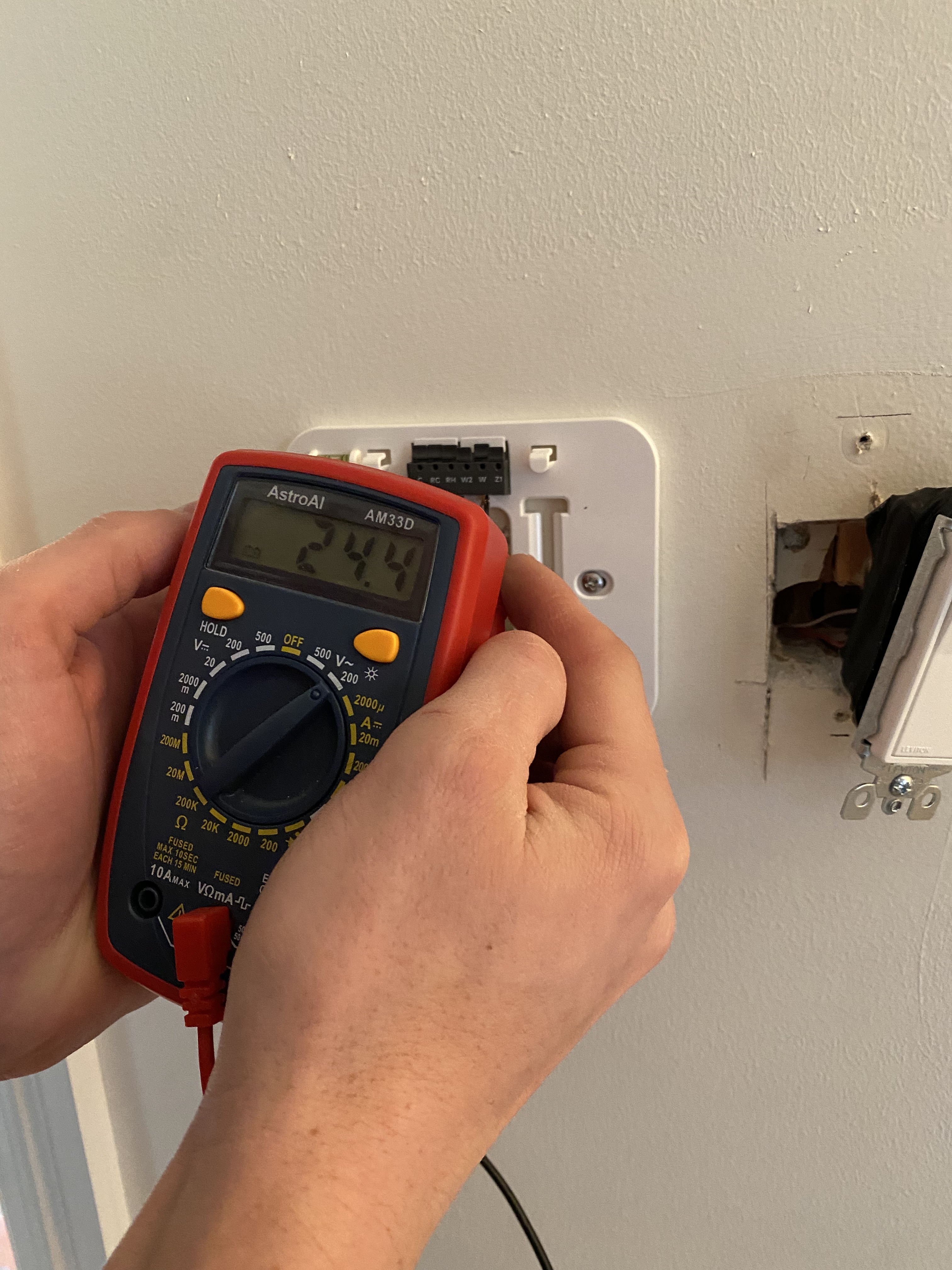

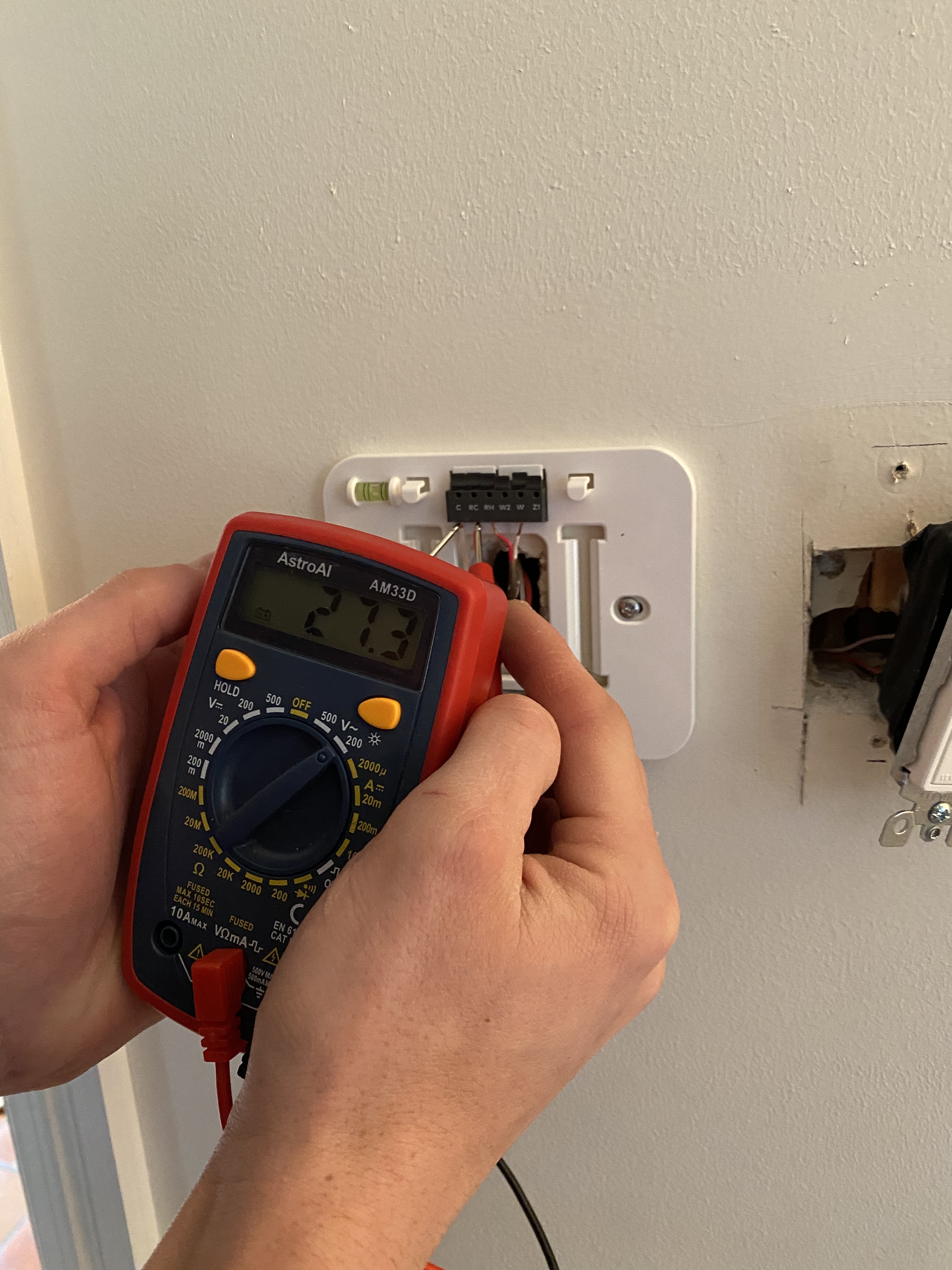

Jason–I’m still not having any luck with this. I connected my boiler to Rh and W and my 24VAC transformer to Rc and C. When I run the setup for the T3000 it detects the Rh, Rc and W wires but not the C. I have tested the wires from the transformer with a multimeter to confirm they are 24VAC. Some sources online suggesting splicing two wires to the Rh (so I would have Rh (with hot wires from both the Taco valve and the transformer), W (going back to Taco) and C (going back to transformer). Any thoughts on what could be wrong. Should I try splicing?

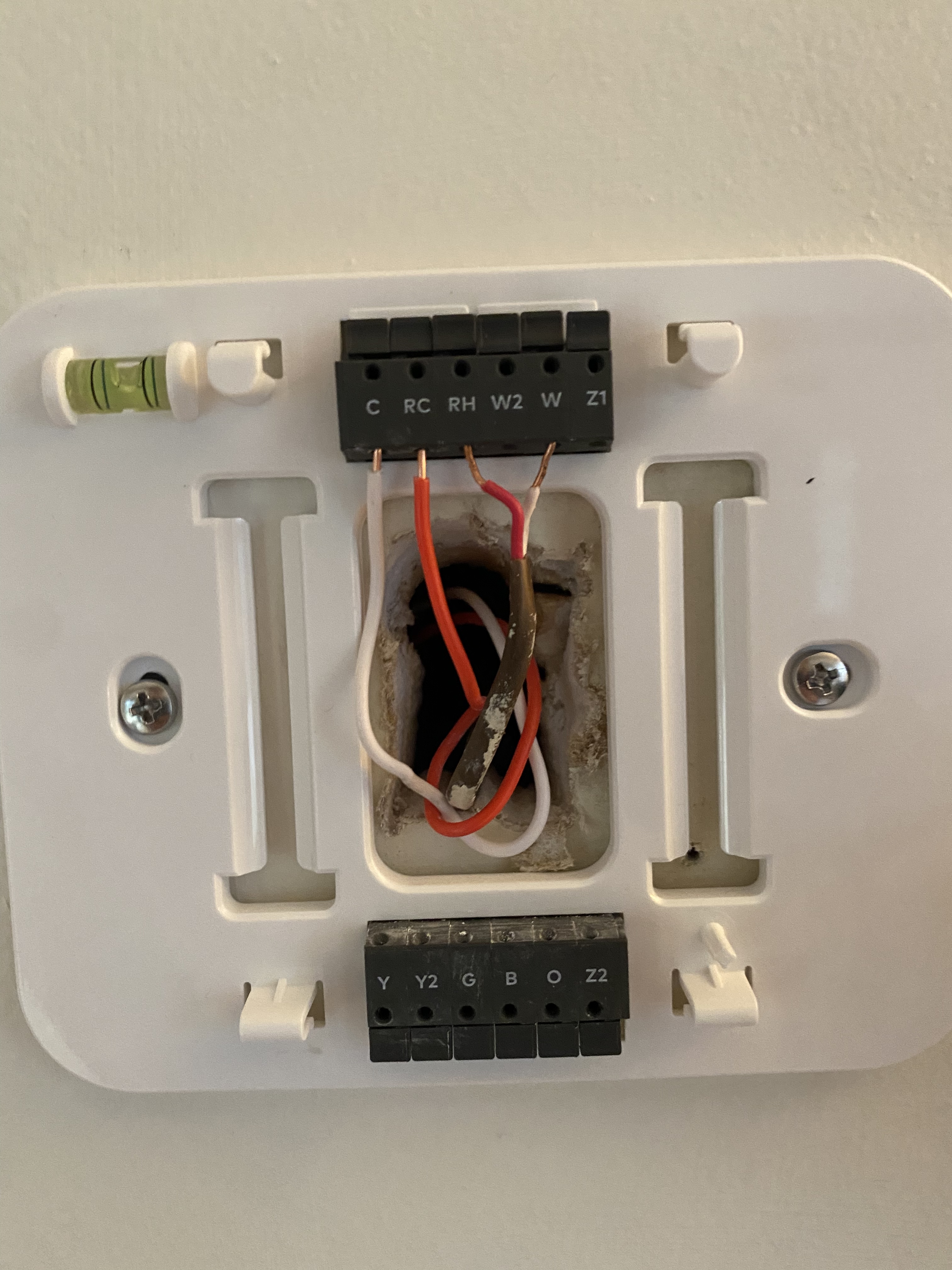

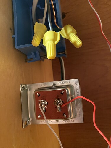

That is why it did not detect it. The thermostat should be powered up by a 24VAC transformer. Can you post a photo of the thermostat wiring, the transformer label and its wiring?
Thanks for your help Jason. See below. I included two pics showing the AC voltage running through both sets of wires. The set on the left go to the transformer (also showed—outside of electrical box to make it easier to see everything) and the set in the right go to my Taco zone valve.
I am wondering if your thermostat is currently jumped digitally between Rc and Rh and that may be causing the issue. If you shut off power to your heating system, confirm that voltage is not present on the Rh wire, then try setup without batteries in. Does that power up the Tstat and let you select the Rh and Rc setting?

Just out of curiosity, could I also just run a wire from the C to the transformer attached to my boiler? The new transformer I installed is right next to that.
I would expect so, though I would use a C terminal on the heater if available.
