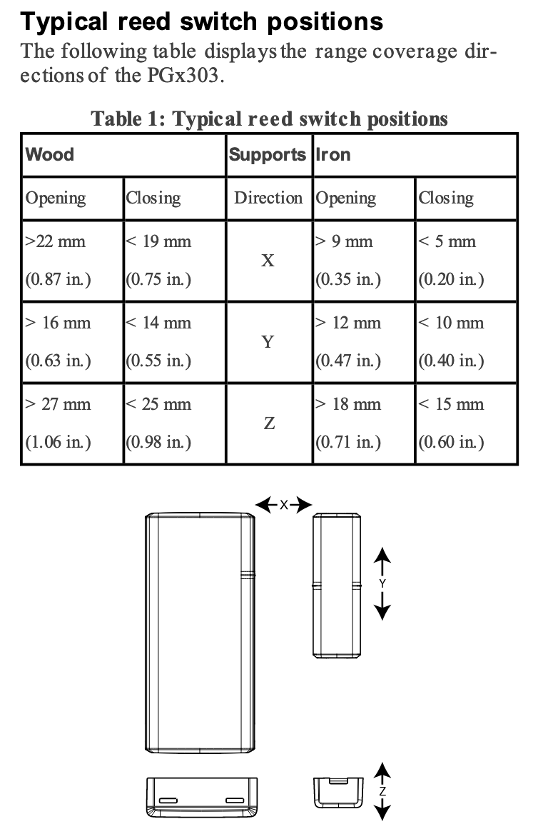

Diagram from the manual below. It also depends on the material the sensor and magnet are applied to.

You can see it seems to not trigger “open” until 1/2 inch apart, but for it to trigger “closed”, it doesn’t happen until it’s much much closer together
Unless the video is mirrored, that magnet is on the wrong side of the sensor. Be sure to line the middle of the magnet up with the small ridge on the side of the sensor. That is where the reed switch is.
Ah yup that would do it. Did not see that. Working better now. Thanks!
