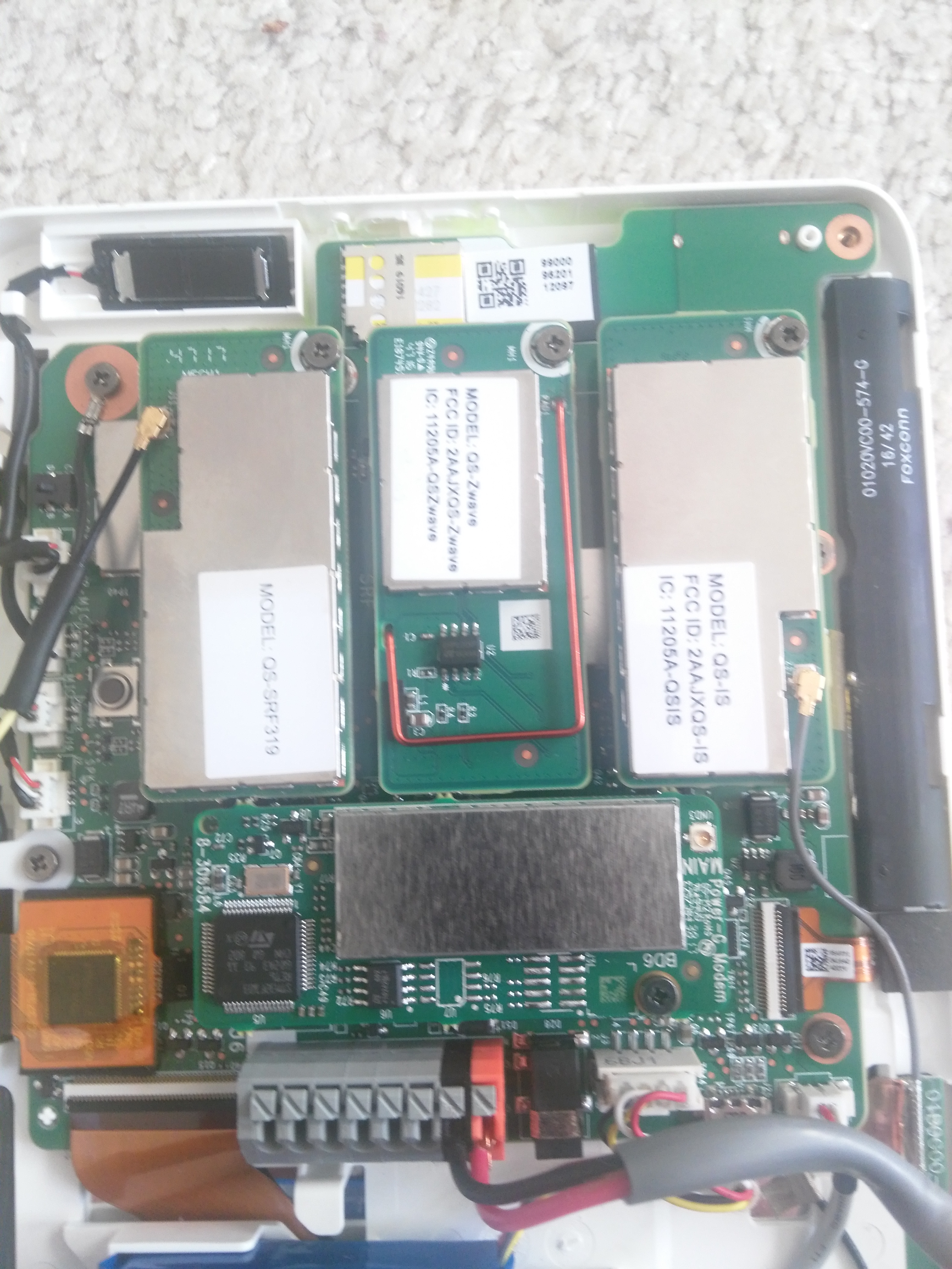

Just to follow up here, I have finally had some free time to test.
I was able to put the image card in a IQ 2+ and have it function fine.
Well I did not permanently move the IS sensor antenna from the other panel. I piggy backed it (see photo).
Of note, also, I do not have any power G sensors, but I’m sure it would be fine. I may get 1 as I have a motion sensor in the garage that is far and flakes out its connection from time to time.
Next up I spied the usb header on the board and will see what that may yield.
The main reason they don’t co-exist is the Power G card uses the same antenna as the IS daughter card.
