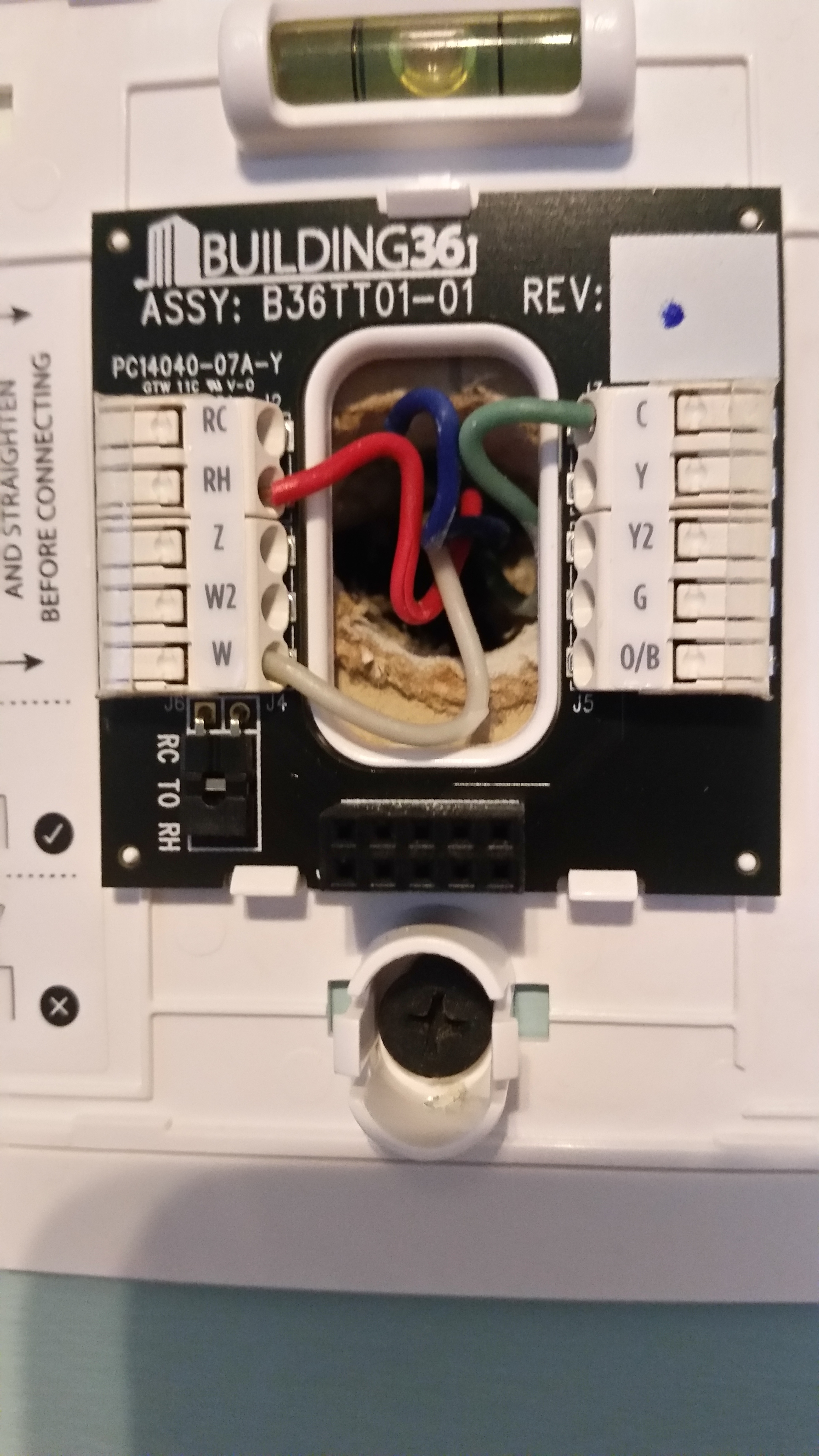

See attached photo of wiring. The green wire leads to the common at the boiler. I don’t have central AC…just heat.

So you have tested the AC power between RH and C? To be sure, set your multimeter to test AC, then test with the leads connected to RH and C wires. Is it 24VAC?
From the description it really sounds like the common wire may be loose or damaged at the boiler end.
Use wires from the 1st thermostat (which uses the common perfectly) - still no power
By no power, do you mean the thermostat did not power on when attached to the wires?
Are you cutting power to the Boiler before making wiring changes? Attaching live wires to the thermostat terminals can cause shorts to occur.
When the 2nd Tstat is wired to the circuit that was previously delivering voltage, did you test to make sure voltage was being delivered at the time? Switching live wires might also throw breakers or blow fuses depending.
