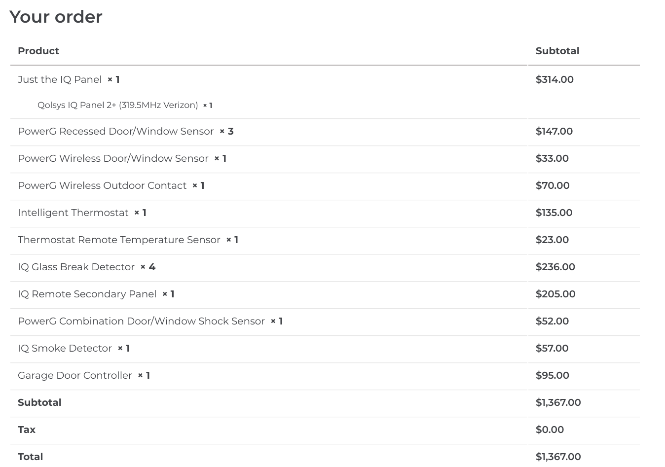

Foundation was just laid on our new home and the builder let us know to make sure we know what electric wires we will need for our security system. Since home will not be hardwired with door window sensors, is there anything specific that needs to be done so that panel and outdoor cameras can be powered with the main power from the home??
I’ve filled my shopping cart already with all the equipment our home will need and since majority of it is battery powered the only concern is the equipment that will be permanently mounted ie. panel, cameras, thermostat, etc.
Here is the stuff we’re planning on:
Only things missing from there are the cameras and svr
