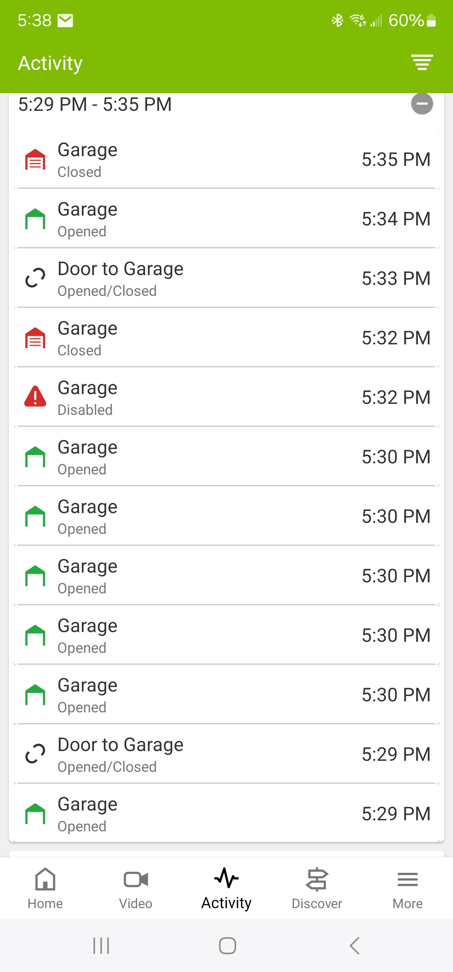

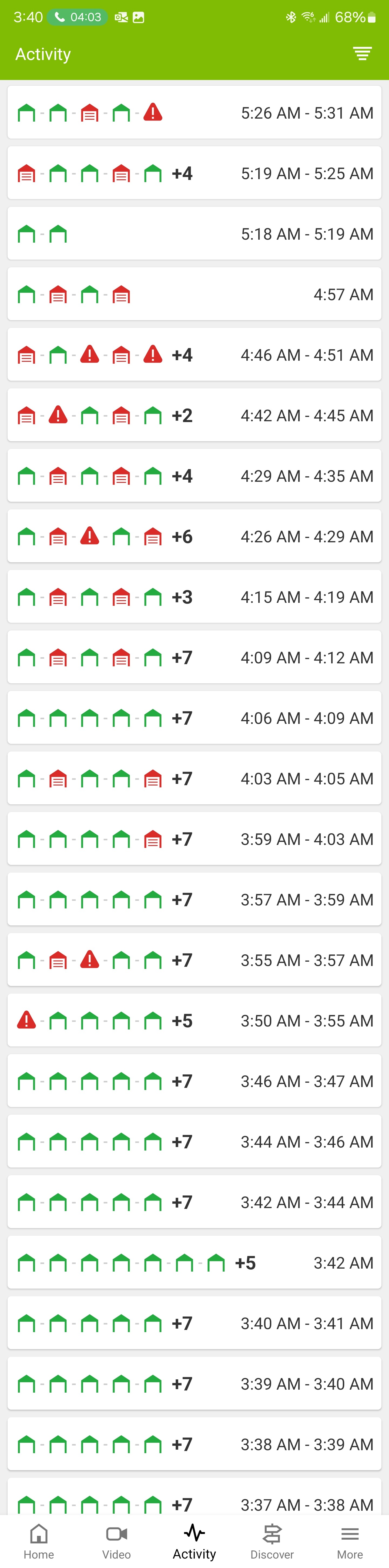

My garage opener has decided to open and close itself repetitively. Has anyone seen this before?
To confirm, are you onsite and is the garage rollup actually going up and down, or is it just reporting like this in Alarm.com?
I believe it’s actually moving, because I found it partially open
