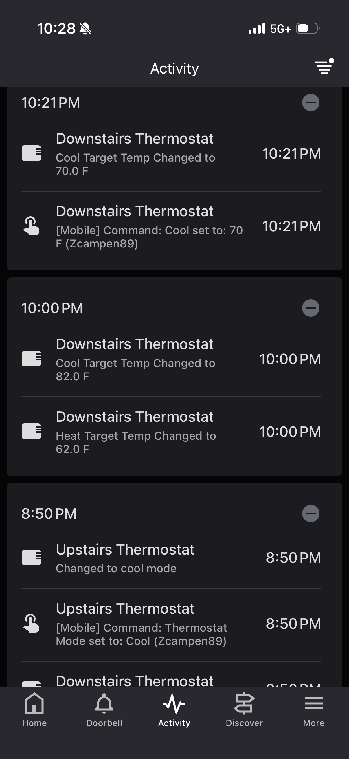

I’ve noticed that our downstairs thermostat will randomly decide to choose temps out of thin air on occasion. For heat that temp is 62 and for AC it’s 82. Neither of these temps are in my schedules. Any idea why it’s got a kind of its own? Thermostats are honeywell t6 units. This appears to just be isolated to the downstairs one. Bellow is a not of it at 10 pm on 4/23

82 and 62 degree set points I believe match the pre-programmed Sleep schedule on a T6 Pro. Check for that Sleep schedule.

Might have fixed it. I could have sworn I turned that off but there was a schedule on.
