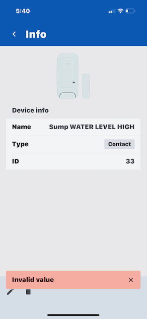

That’s exactly what I did, and it wouldn’t save. It gave me an error.
I just tried it again.
Note I’m using the IQ Installer App.
In IQ installer, once I save the settings I get this “Invalid Value” error:
So, I exited the IQ Installer app, and did this config direct on the IQ 4, and there it DOES work and will allow me to save it.
So, I suppose this is a problem in the IQ Installer app?
Thanks for your help.
I didn’t even try direct on the IQ since I never thought the Installer app could be the issue.
