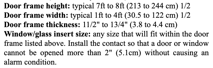

Yes, the installation manual here specifies mounting the magnet on the moveable part of the window/door and the sensor to the frame.
Below is a section describing dimensions of the door/window from the specifications list in the manual.
