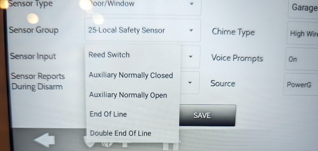

So I can’t get it to work correctly. It gets enrolled, and there are some type options - reed switch, aux nc, aux no, etc (see picture). Reading their literature, i think the reed switch refers to the main magnetic sensor. So do I only get to pick one? Can I enroll twice and select a different option?

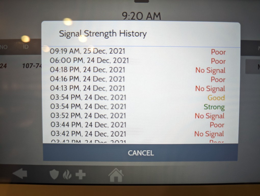

All that is moot though, as it doesn’t really work. The tamper signal gets transmitted quite well, but the switches don’t seem to operate or send a signal. The panel always reads the zone as “closed”. The “local diagnostic test” in the PG9312 to test signal strength comes back “poor” (even though the tamper signal works great).
I have read the other posts: My height is about 6.5ft, and the distance to the IQ4 is about 60ft thru 1 wall, no real metal in the path, although the garage rollup door is right behind the sensor, opposite way from the panel. There should not be an issue with poor signal. Or is this a new problem with the IQ4? Or is my sensor bad? (but the tamper signal always gets through…)
You would learn that in again, typing in the ID and selecting the appropriate function (aux open or closed, typically most sensors are normally closed). Reed Switch is the internal switch opened and closed by the magnet.

PowerG has adaptive battery power, so the signal may fluctuate a bit shortly after learning in the device.

Not when set to reed sensor
Not when set to aux N/C
Not when set to aux N/O
Not when set to EOL
