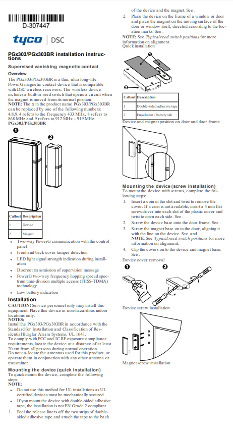

After reviewing the installation guide linked here, it appears the adhesive method applies it directly on the back of the magnet and is then mounted to the wall, where as the screw method has you open the magnet’s case then install and reapply the casing. The top reference image of the attached manual appears to have holes before applying the adhesive.

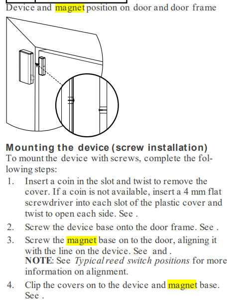

It does look to be the same surface for both methods. Are you able to open the magnet’s case to see if there are holes in the back? Attached is an image of the manual for reference. It mentioned screwing the magnet’s base on step 3:
"3. Screw the magnet base on to the door, aligning it with the line on the device. "

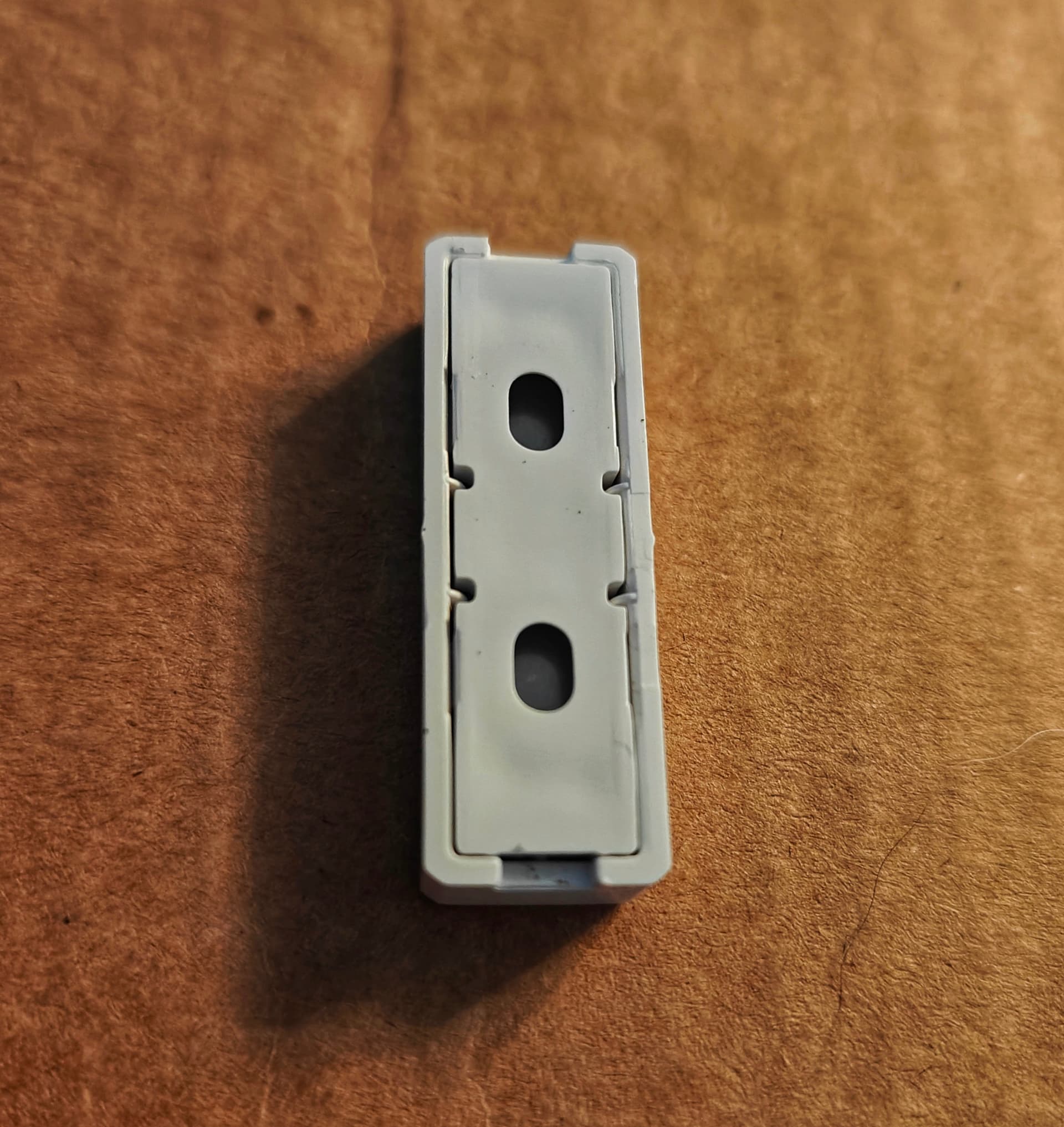

It does look like there are potential screw holes at the back of the magnet; I just wasn’t sure if they should be actually slid onto some posts of a separate piece (as for PG9935):
I think I’ve used as much force as I am used to opening cases of PowerG sensors and just want to double check before I force it further. Moreover, the magnet is now rattling inside. It is clear how to mount the detector component with screws by opening the case; I’m just not sure about the magnet component.

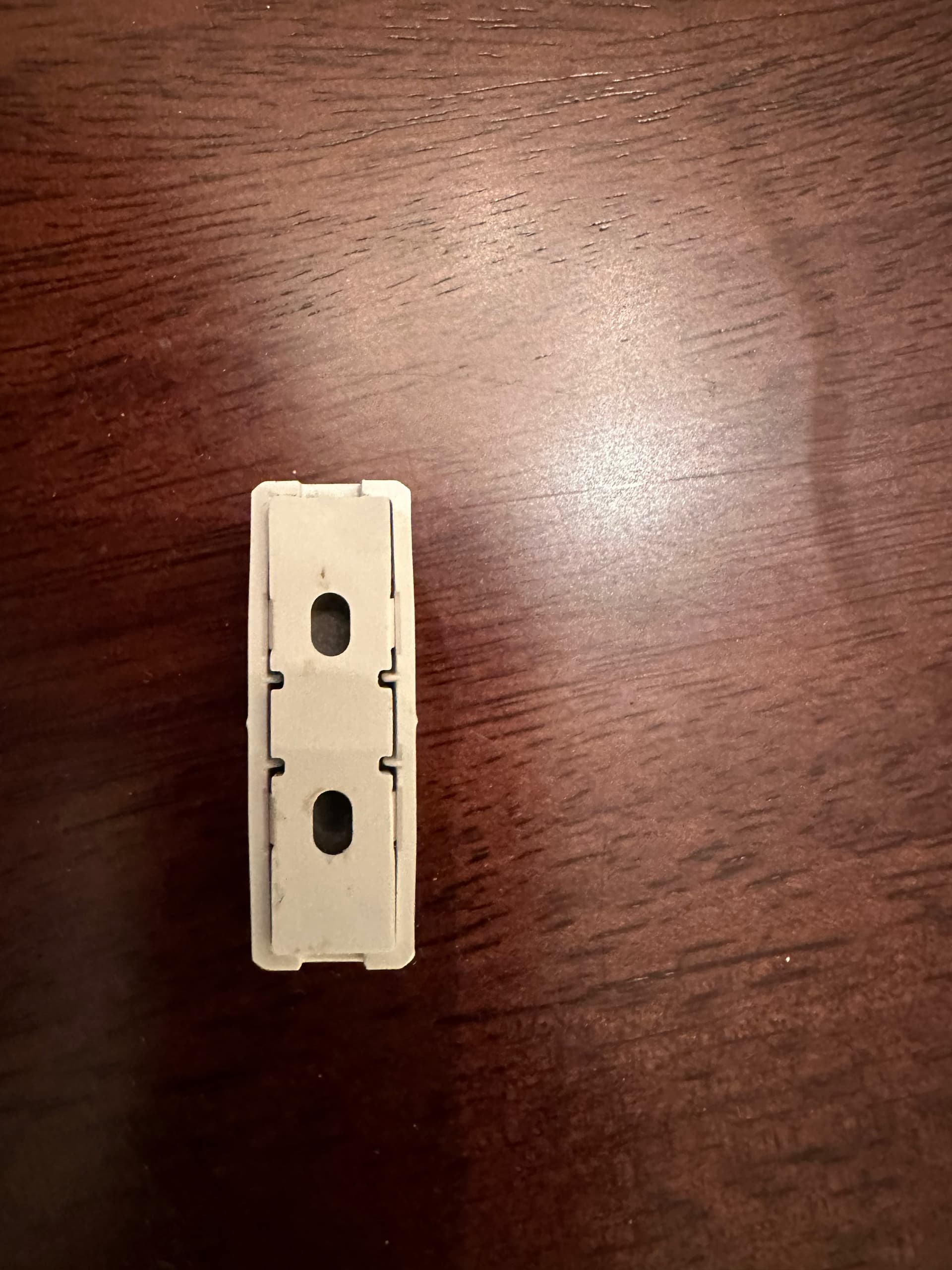

I was able to get ahold of a PG9303. The magnet has 2 indents on each end that are able to be pried opened to reveal the screw indents. Attached are closer images of the device with the indents visible after opening.
I will respond with what DSC has to add and if they have any other tips. After opening, it is only a metal bar (magnet) and no electronics, the rattle may be from this being unseated from it’s position.
Please let me know if you have any other questions, I am here to help!
Great, thanks – this verifies I should just keep prying harder to take it apart. I won’t work on this til next weekend, so if you get any other word from DSC I’ll appreciate it!
