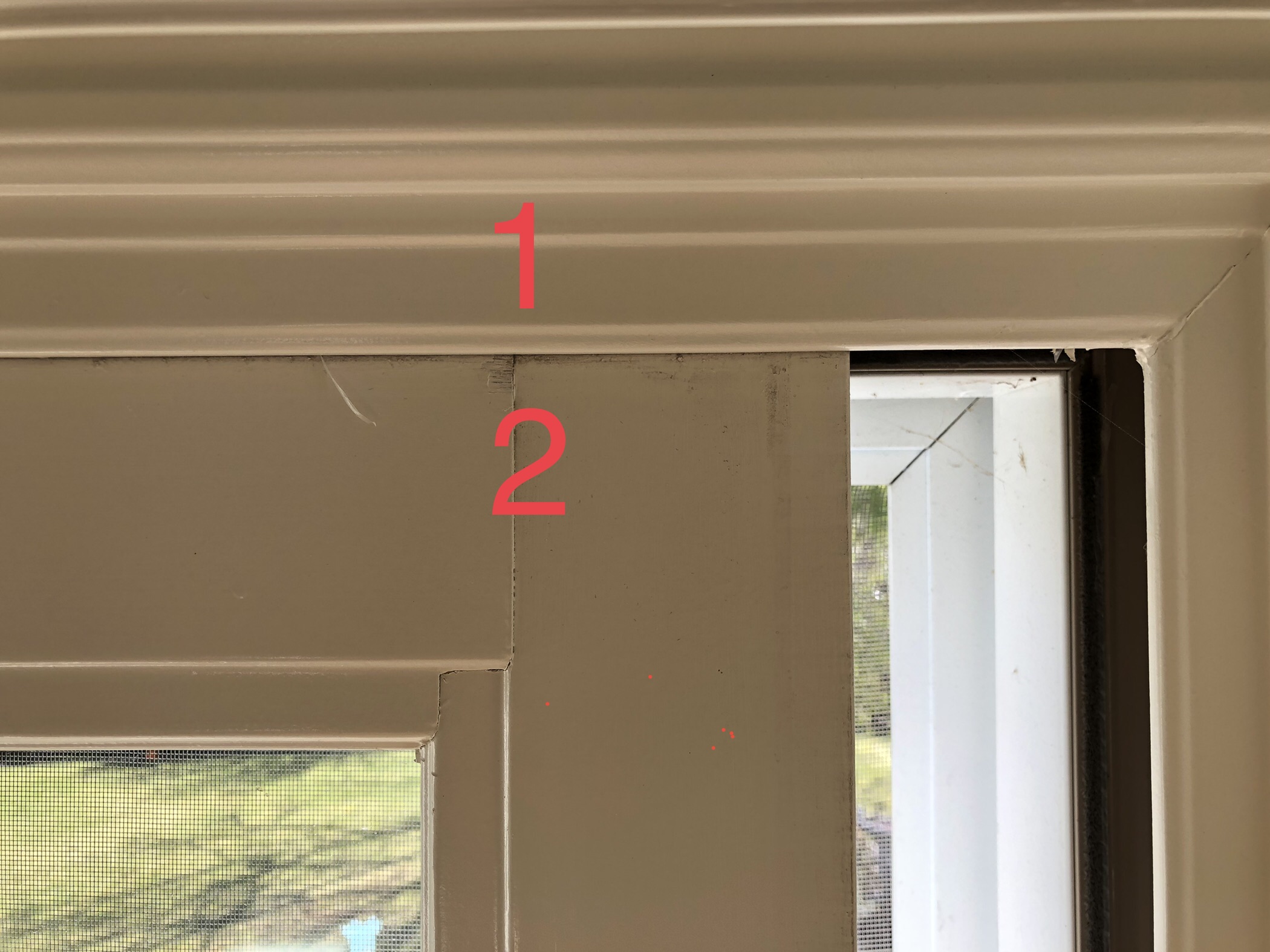

i’ve been unable to elicit any sort of consistent or reliable shock detector response on the sliding door pictured below when mounting the sensor in area 1.
would a different setup such as an on-glass sensor wired to an IQ mini D/W extended sensor work better for this type of sliding glass door? or any other suggestions?
I am a fan of wired on-glass shock sensors. I have had good experience using the GE 5150W. However, if you have not calibrated the sensor yet I would try that.
yes i also tried sensor on door, even though i know it’s not recommended. when calibrating, i can sometimes get a “4” when knocking on the wooden frame or striking the window with a screwdriver handle, but then if i replace the cover i cannot generate the same response, even when placing the sensitivity to 1.
A wired on-glass shock sensor like the 5150W or similar model may be more suited, but you would need one per glass panel. They can be wired to the same sensor in series, or they can be wired to different sensors.

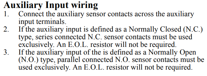

Installing the GE5150 with the PowerG contact sensor + Aux.
I learned the sensor to Aux (instead of reed switch) but I have the option of NO or NC. I presume the 5150 is NC?
