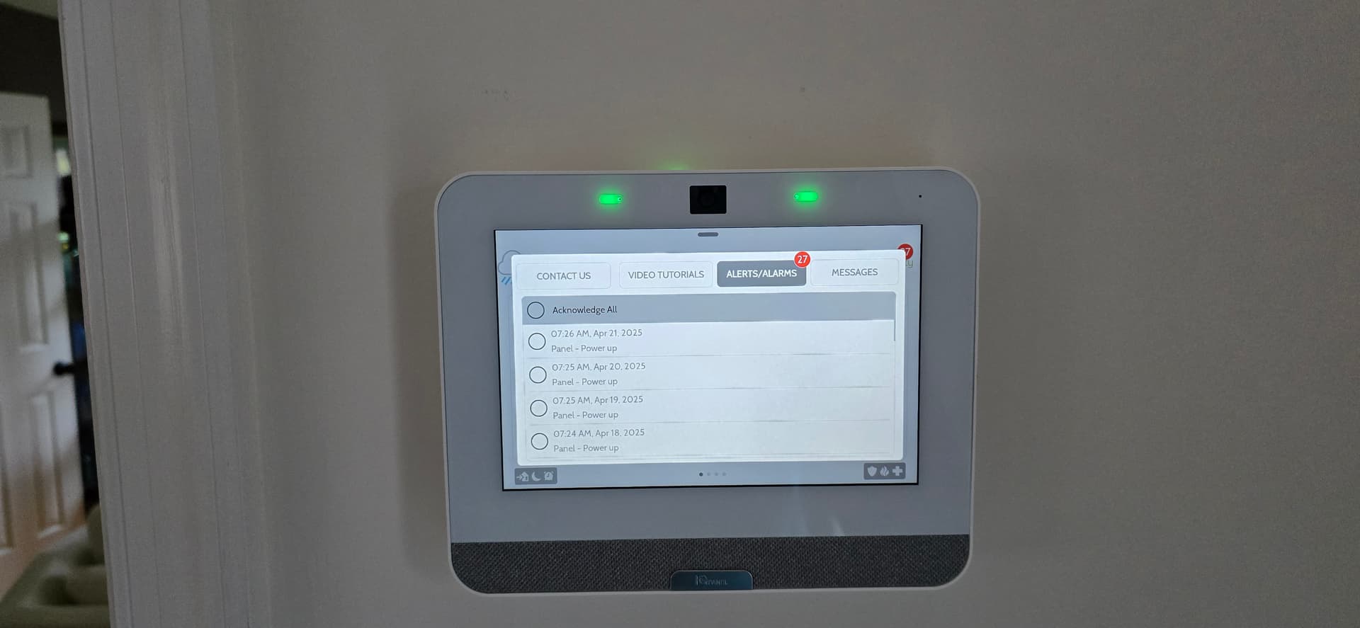

I don’t typically look at my panel as I pretty much just use the app or secondary keypads…but yesterday I noticed there were 27 notifications and they were all stating that the panel rebooted. It also appears that the panel reboots around the exact same time every day. Today I watched around the time it’s been reporting the reboot and it surely did fully reboot. This is concerning considering that the system is typically armed at this time and I wouldn’t expect the system to power cycle unnecessarily while armed. Has anyone else experienced this or have any input?

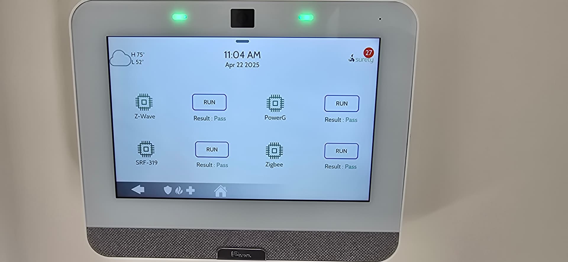

If you enter Settings > Advanced Settings > installer code > System Tests, run the Daughter Card Tests and then run everything under Panel Tests. Do you notice any failures?
Jason, thanks for your reply. All daughter card tests passed.
I ran a panel test, everything came back okay except for the Camera- which has been failing since the most recent firmware update. Rebooting fixes it for 5 minutes and then will fail again.

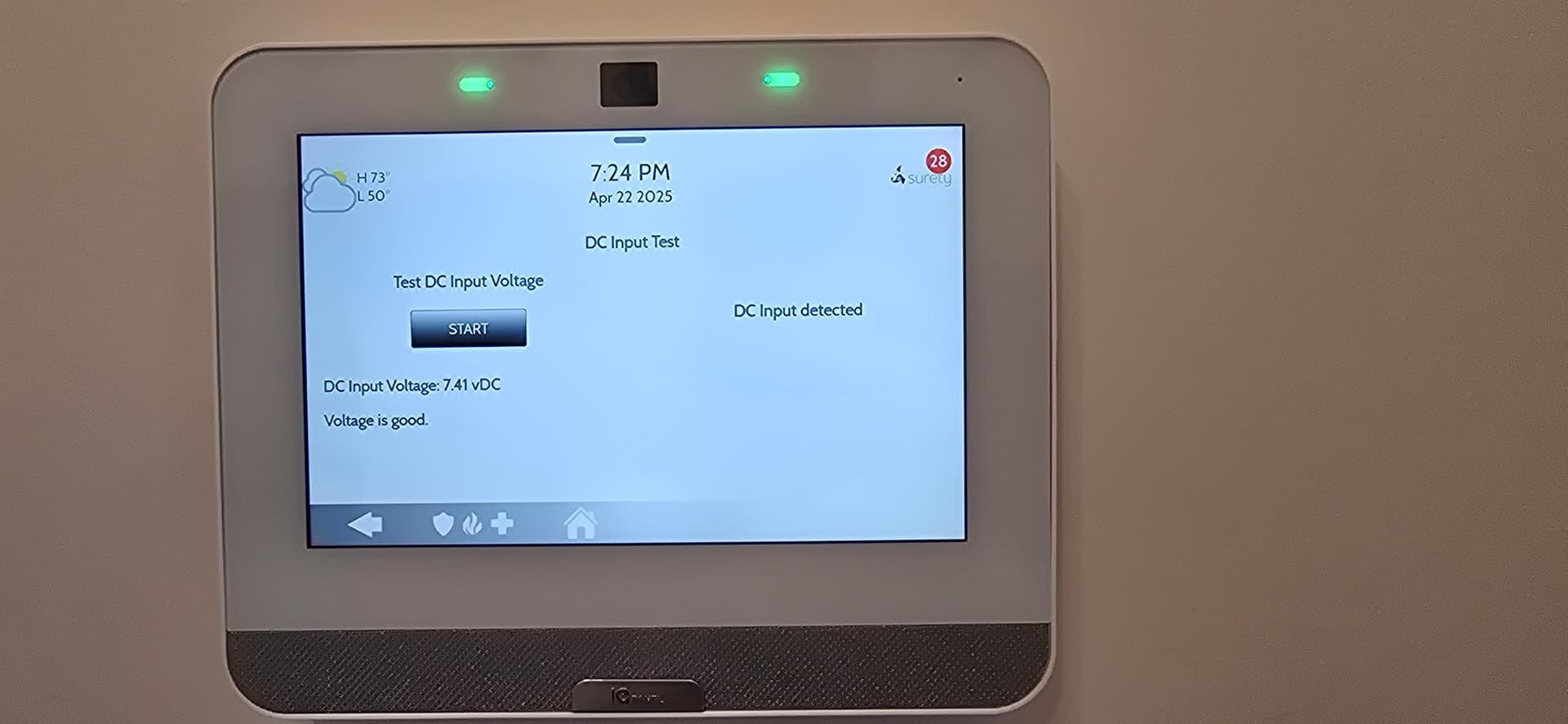

Can you perform a power input test as well. This can be done by swiping down from the main screen > Settings > Advanced Settings > Installer Code > System Test > Input Voltage Test

This test also passed without issue. I am not opposed to resetting it to troubleshoot.
