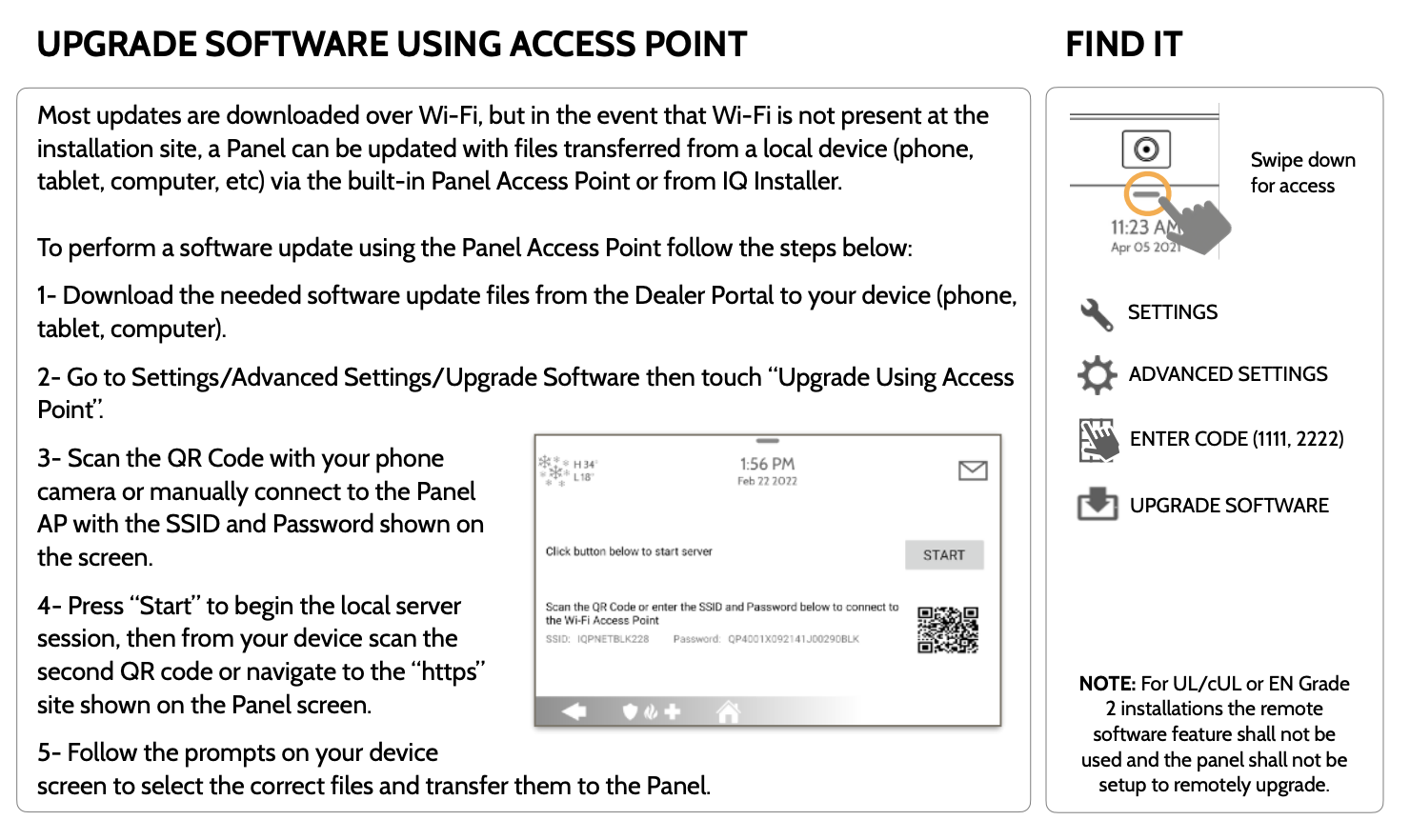

Is there a place where we can download the zip for either 4.5.1 or 4…5.2?
The link to download the 4.5.2 zip for update by access point is here.
You need to already be on version 4.4.x to use this or it can make your panel unstable.
