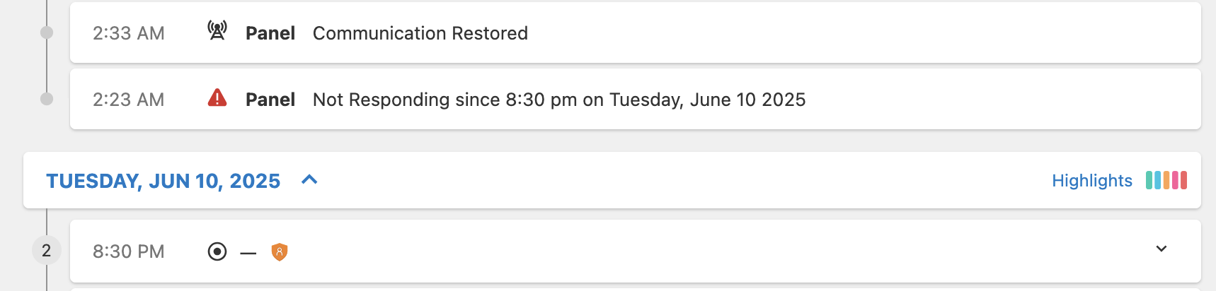

Hi, I have an older Control4 system with a cell modem. Got a notice early this morning that my panel connection had been not responding since my automation armed it the previous night.
Now any remote action seems to fail/timeout regardless of the user trying it, but local actions at the in-house panels work, and the remote system/portal seems to be out of sync. Given the communication error in the wee hours, maybe it needs to be hard reset? Open to all ideas. I presume there’s nothing odd that you see in the backend anywhere? Is the best way to hard reset these older systems to unplug the backup bat and kill the breaker?
I did look into the communication for your panel. I noticed that the last signal strength update of one bar out of 6 was sent at 4:13AM CDT on 6/11/2025. Before this, it was constantly getting 3 bars and sometimes dropping to 2 bars. 2 bars is the minimum required to function properly.
