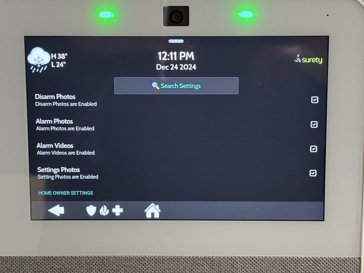

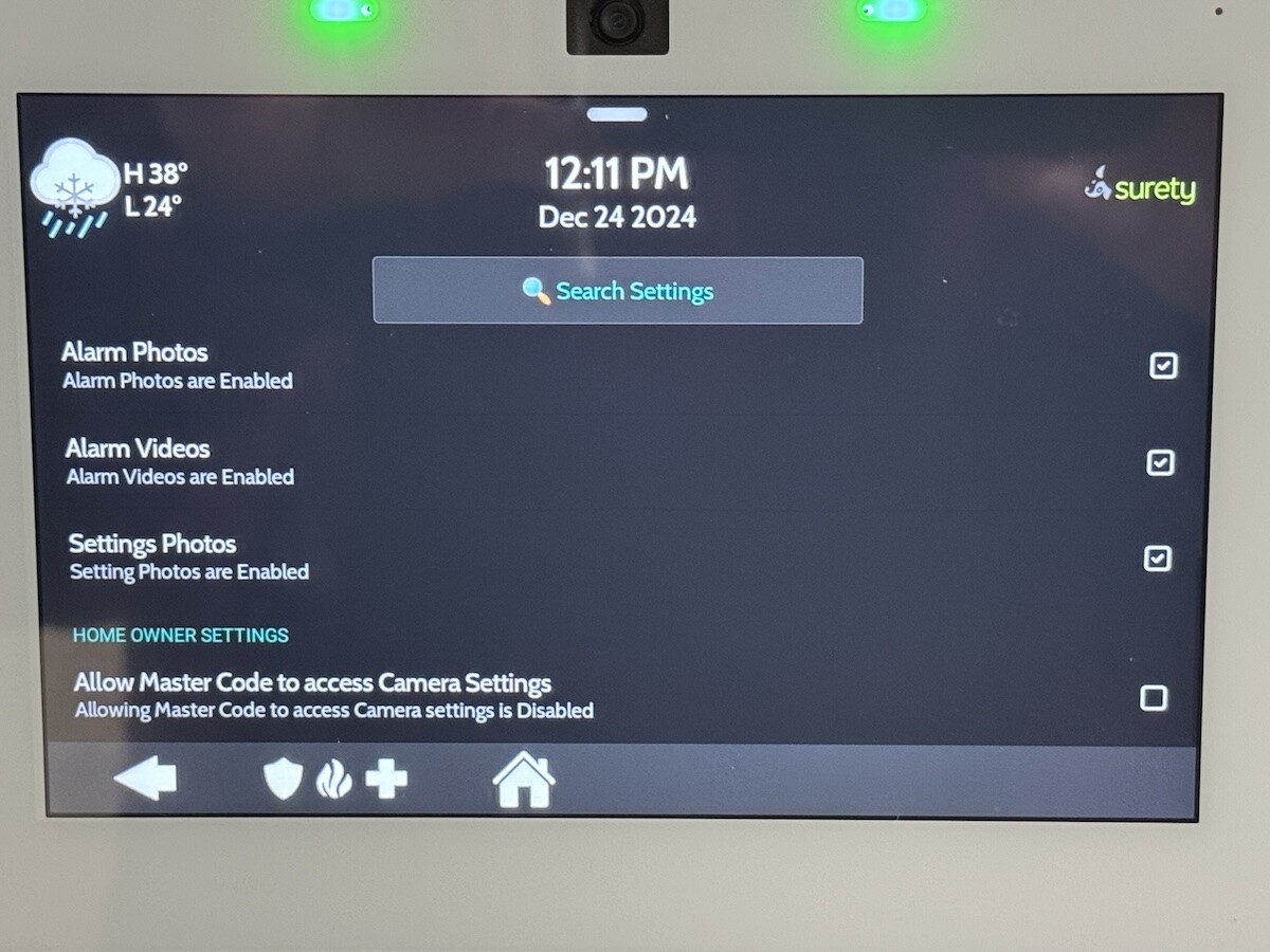

Out of curiosity, in Camera Settings, what items do you have disabled?
No rush… and also no failures since I posted this yesterday.
Here are screenshots of my camera settings:
