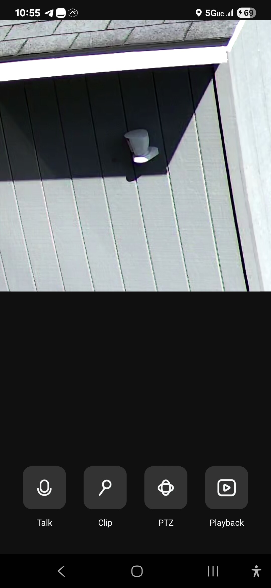

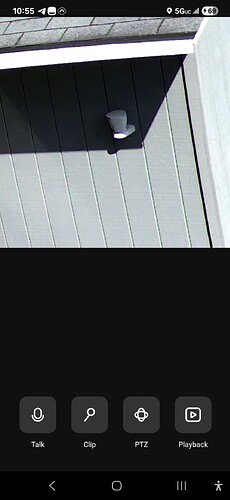

Here is a grab from a poe cam. I’ll double check the tampers when I get home. I’m not seeing tamper faults on the panel.
We’ll need a closer picture of the device when you get a chance. Check for any loose screws or mounting hardware as well as a loose cover.

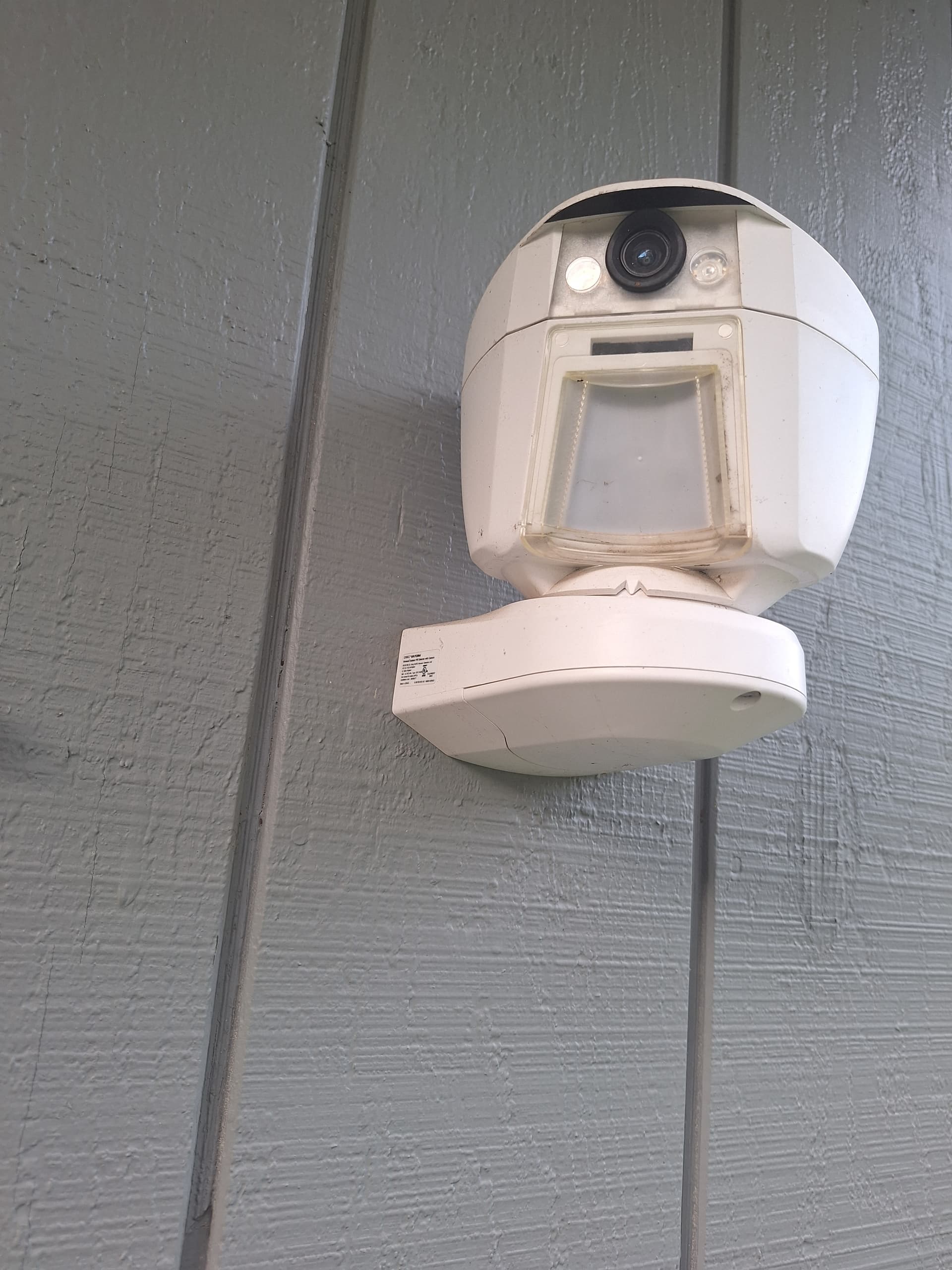

Took it down amd inspected the various tamper devices and switch, all seem yo be in order. Here is a good photo of it’s mounting.

Nothing has been solved, still the same mystery fault causing a constant bypass condition. I’m about to just throw it in the garbage.
If it is still being bypassed, I would recommend you delete the PG9994 and learn it back in.
Do delete, you can swipe down from the main screen > Settings > Advanced Settings > Installer Code > Installation > Devices > Security Sensors > Delete Sensor > Select this motion and confirm the deletion
Press and hold the learn button until it flashes red 3 times on the PG9994
You can then back out to the sensor menu and press Auto Learn Sensor
Press and hold the learn/enroll button until the LED lights up orange and release immediately.
Finish programming on the panel and exit programming. Test arming
