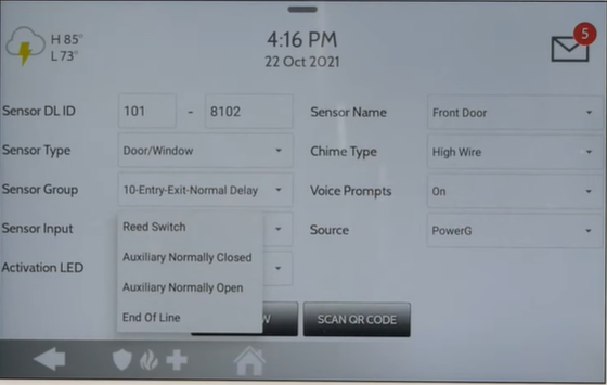

There is a video on YouTube covering the IQ4 + PG9945 specifically and it shows the IQ4 recognizes the aux input under “Sensor Input” option. It appears like it’s an either/or scenario so you can’t use the internal reed switch and the aux input at the same time, but that shouldn’t be needed in your case.
Here is a screengrab in the video:
if your float switch is functioning like a typical NO sensor then you should be able to simply splice onto the float switch wires and wire them into the aux input on one of these sensors then program the sensor as “Auxiliary Normally Open” and you will be good to go.
