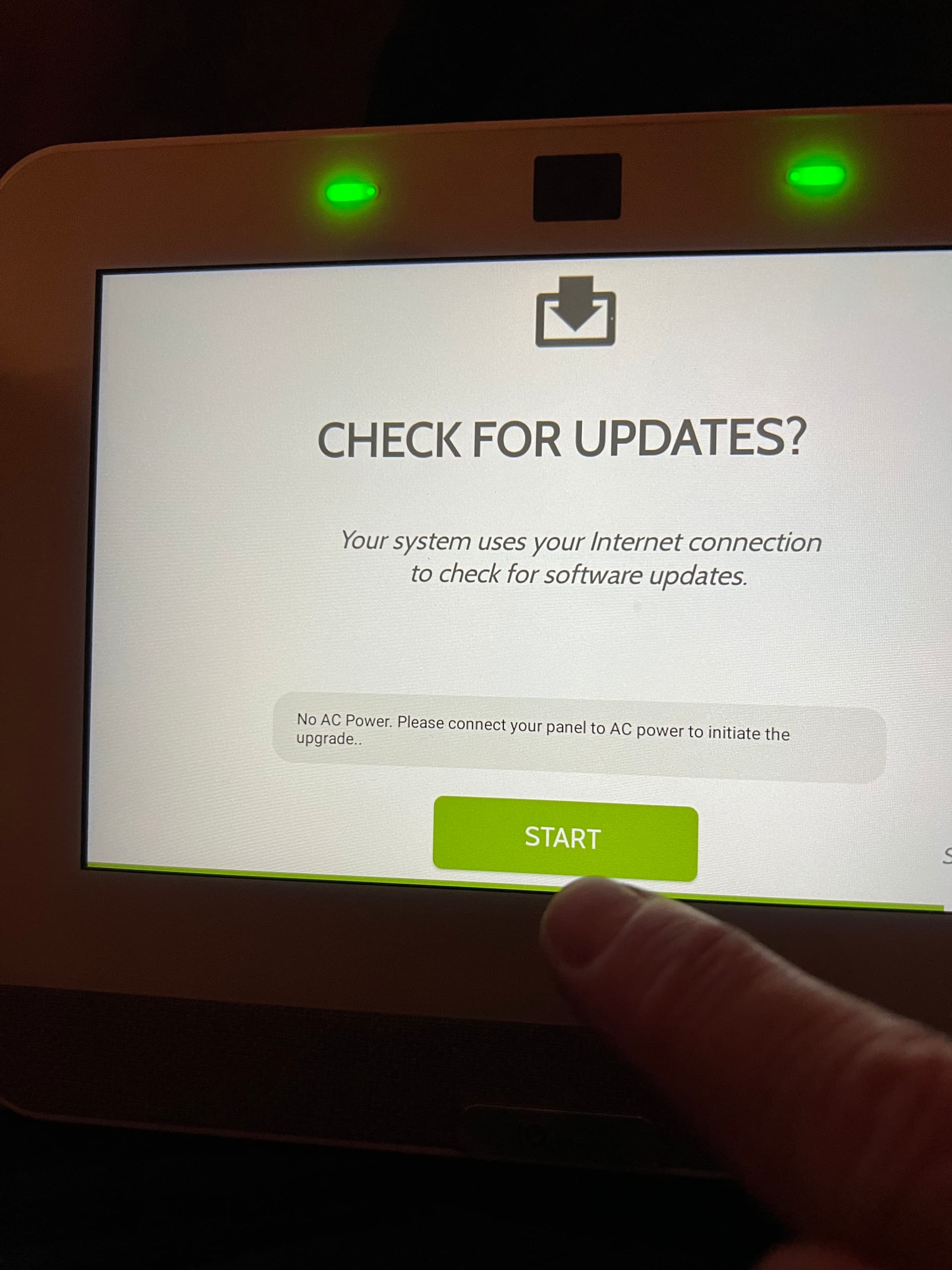

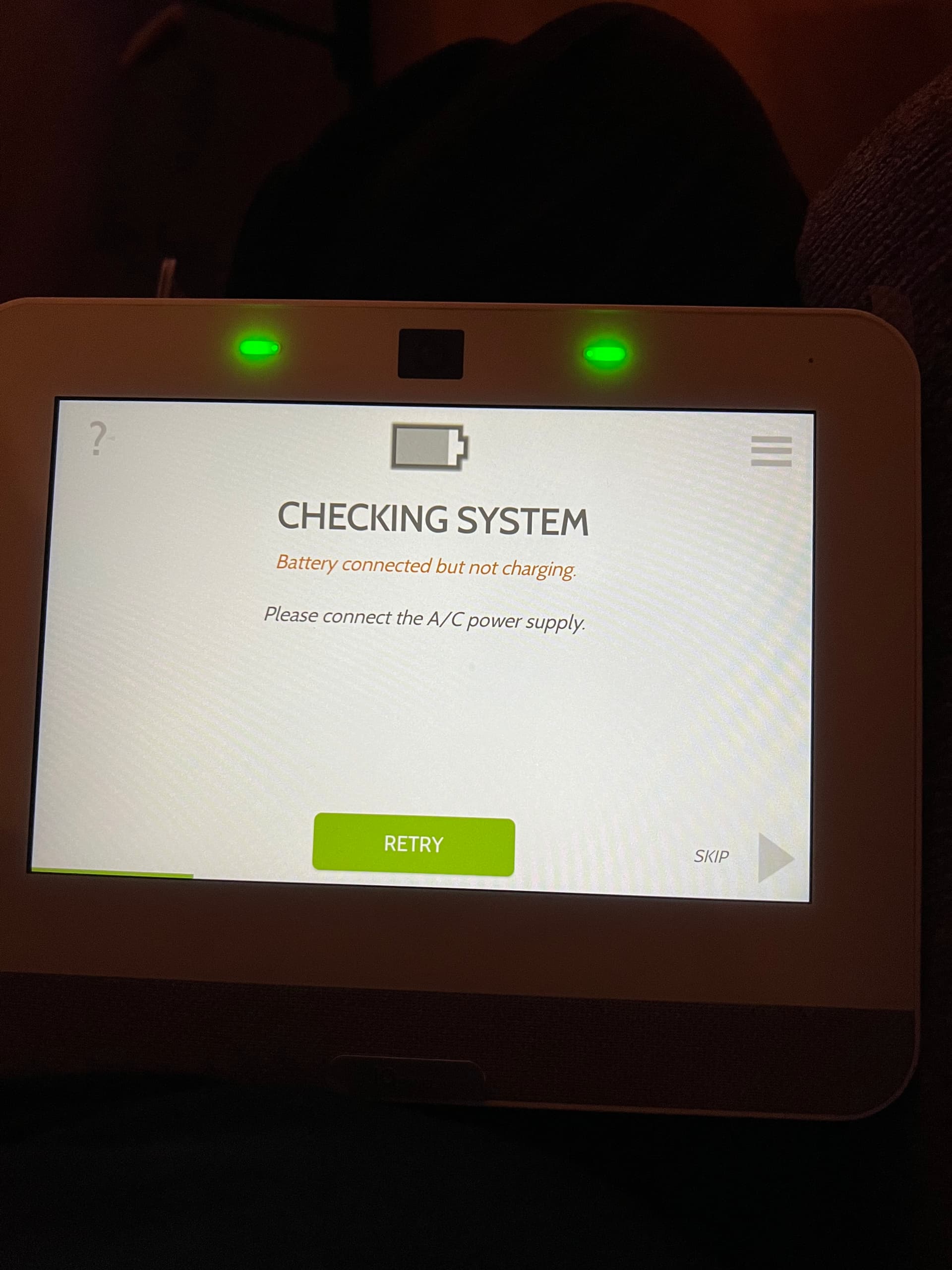

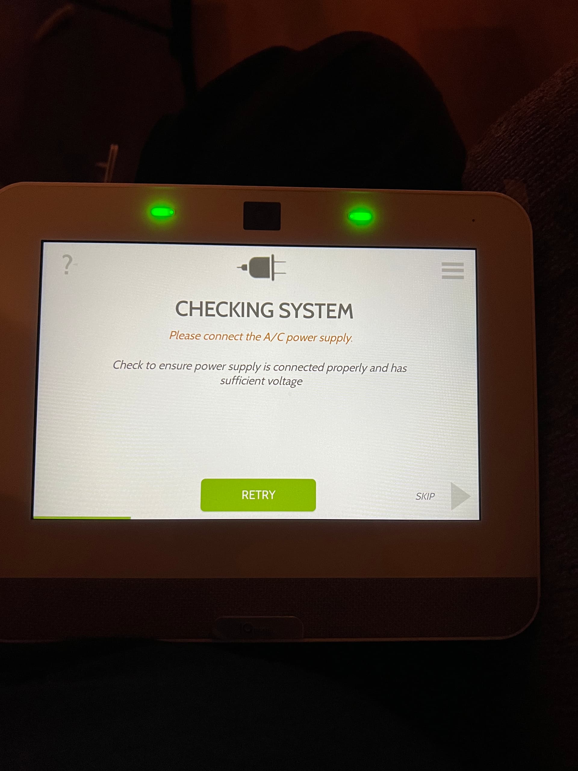

I have a Qolsys 4 panel that I just opened and went through the wizard and it is saying that it is not connected to ac power and the power supply is plugged in. I am using the barrel connector.

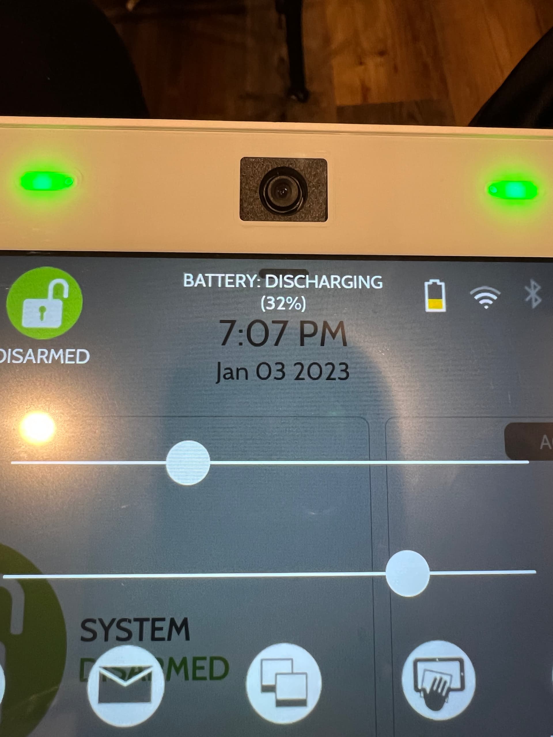

It’s running with the cable plugged in but it says there is no ac power. And I also tried other outlets, I disconnected the battery and it still doesn’t recognize a power adapter is connected. I know the outlet works fine.

No I already packed it up and I’m at work. It is not recognizing the ac adapter and with out it I can’t use this panel, I would like to return it for a replacement please thank you. The main screen comes up and says the panel has issues that need attention and the power supply says no ac power.

Does the panel power up with the power supply but no battery?
no

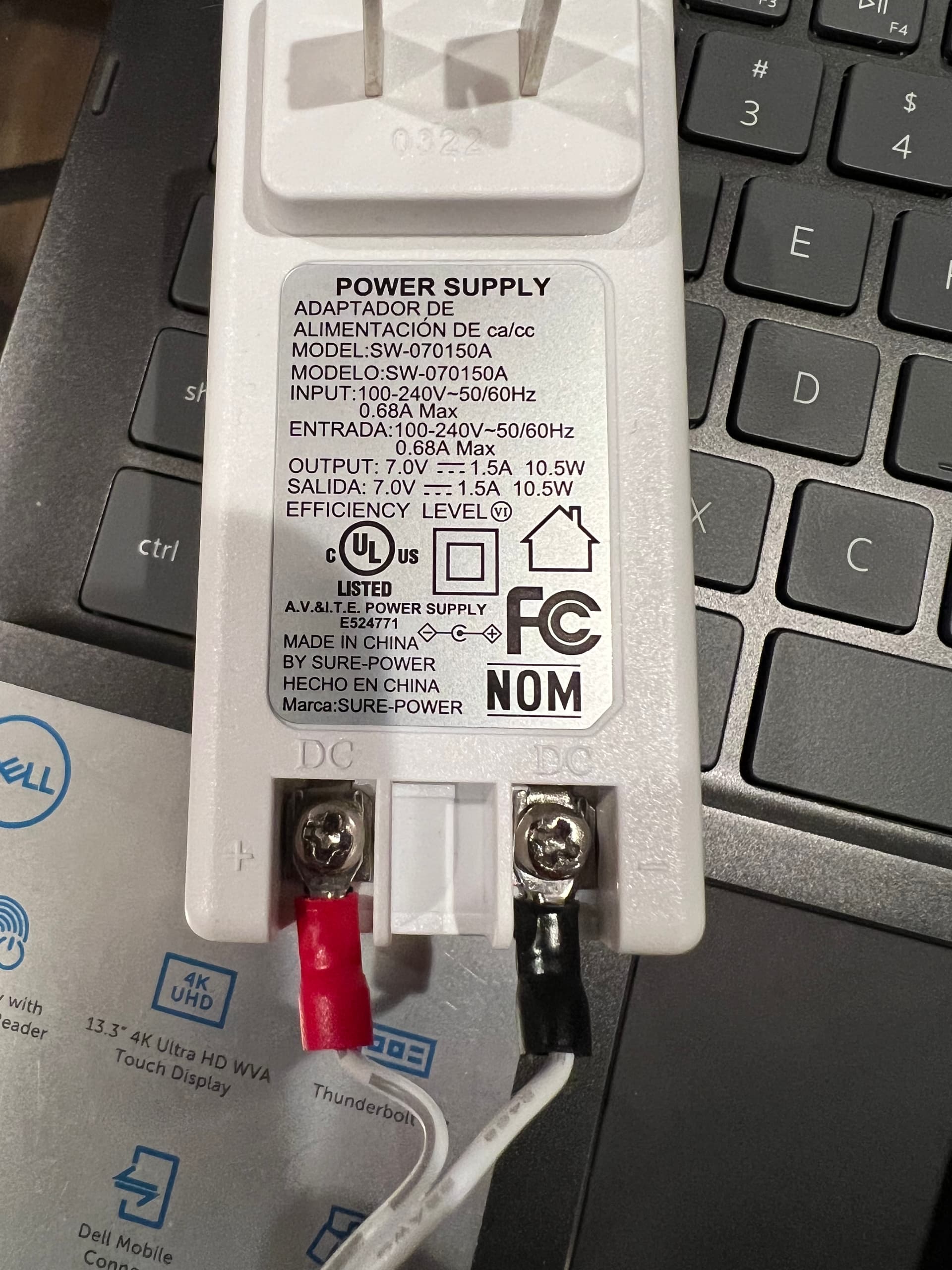

There is nothing particularly difficult, but some troubleshooting questions are necessary. There are conditions that can cause this such as incorrect wire polarity. Generally the manufacturer needs us to rule these out before an RMA can be issued. Looks like we reached out to them for any potential known issues.
If you are using the provided wiring, the striped wire is positive for the barrel connector. That striped wire must be connected to the positive terminal on the power supply. Please check this.
Yes I checked, the polarity is correct.

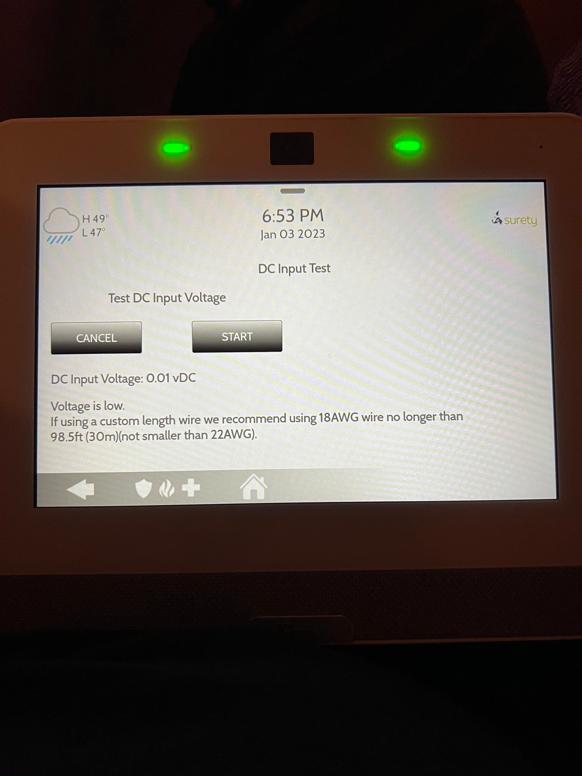

I got into an icon that says dc input voltage test and dc input voltage is 0.0.
can you see the panel on your end? I tried to do a firmware update but it wont let me because the ac adapter is not recognized and it wont update on battery power.
