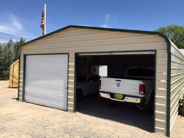

Hello, I have a 2gig system and built a 2 car detached garage. It has 2 rollup type garage doors and one regular door. The building is metal with dirt floor. What will be the best way to add this to my system. My panel is about 30 feet away from the garage.
This is a bit tricky if the construction is all metal, but there are ways around most obstacles.
Are there any windows to secure as well or just the doors?
As far as sensors for the doors, if you want them to be alarm sensors and not simply notification sensors, it would typically be best to use a wired contact connected to a transmitter.
The metal building will prove very difficult to get a signal to the panel, so using the wired contacts is very helpful in that you could drill and run the cables outside the metal wall and mount an outdoor wireless contact with wired inputs.

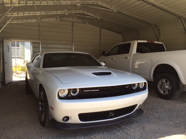

Here are a couple pictures. The rear door has a small window on it but is foam filled metal also.
Your most likely solution is a few of the above linked outdoor wireless contacts (they have a wired contact input) and two garage overhead door sensors and a simple wired door contact.
You may be able to use the wireless sensors inside the garage, but more than likely they would need to be mounted externally (metal will typically cause major problems for RF sensor signals.) They could be mounted in a plastic housing for added protection.

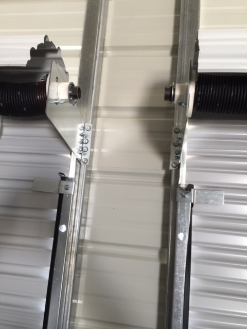

The garage doors are roll up type and not overhead. Not sure I see how the sensor would be mounted on this type of door. Where would I get the outside sensors linked above?
The wired overhead door sensor would need to be mounted to the floor or low on the wall of the garage, with the magnet mounted in such a way the closed door closes the reed switch circuit.
