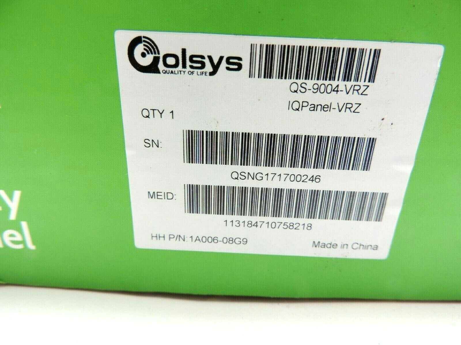

What model of alarm panel did you use with Frontpoint? If you are uncertain of the model, please upload a photo and I can help identify!
I don’t ever recall fromtpoint using. 2gig panel
I was using the QS-9004-vrz. My understanding is that this is a 3g model and not compatible with surety. Looking for the same capabilities but a 4g or supported model. Thanks
Hmmm can u show a picture of camera ur talking about because 2gig and qolsys don’t work together
